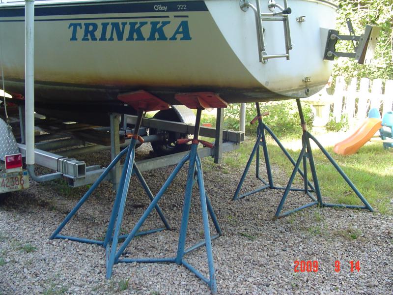

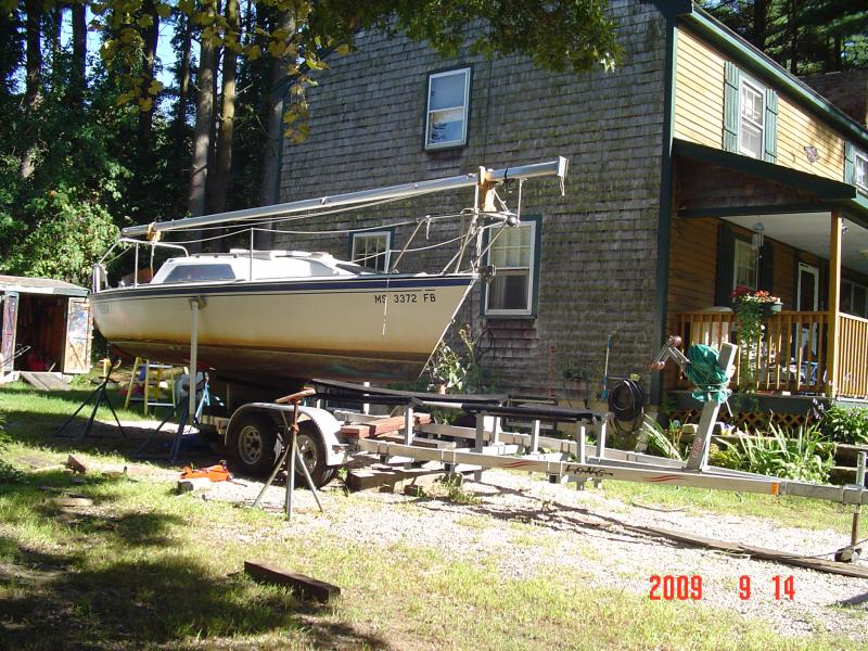

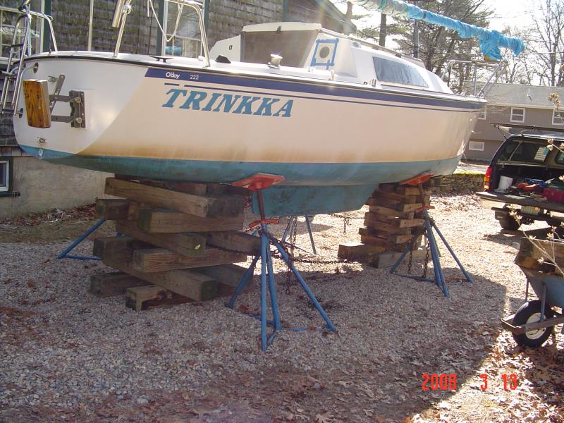

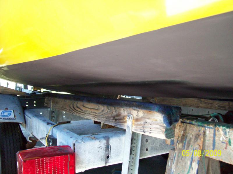

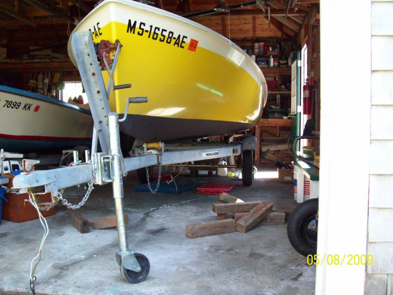

I would take the boat off the trailer. Do you have access to four sailboat stands? Wooden blocks? A hydraulic jack? The O'Day Mariner isn't all that heavy. You could build some sort of a beam to support the stern. The bow could be supported with wood blocks criss crossed.

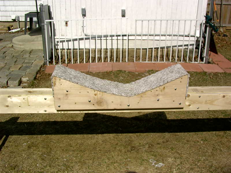

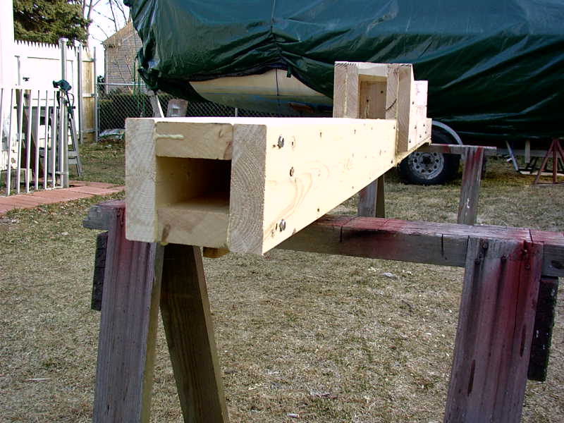

I know. It's easier said than done, right? I know of a guy who built a beam out of 6" planks, Gorilla Glue and lags. Another guy built a support out of regular lumber.

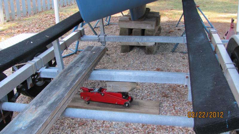

I use four boat sailboat stands, one powerboat stand, 6"X 6"X 3.5' blocks, and my Speed floor jack.
Is your trailer a bunk or roller trailer? With a roller trailer you could tie off the stern of the boat to something stationary like a tree and use your towing vehicle to to get the boat off the trailer and on to tires placed on the ground or a beam. The beam has to be set up so that the boat stays straight so the boat doesn't tip over. You must remove as much weight from the boat as possible. You need to make it as light as you can.
Once the boat is on the ground, you can get some guys to help you tip it up on it's side and Mickey Mouse some type of a way to keep it in that position so that you can get at the board. That would probably be easier and safer than working under it.
I've been taking my O'Day 222 off the trailer and putting it on stands ever since I've owned it. It's easier for me to bottom paint the boat and check my centerboard shackle and pendant line with it off the trailer. The job is easy with the right equipment. Sailboat stands can lift that boat with no problem.
With a bunk trailer:
Place four stands, two on each side of the boat at the stern and use a hydraulic jack placed under the bow to jack her up. Then use a car stand placed under the bow close to the back of the trailer's cross member to hold the height. Remove the jack and roll the trailer forward by hand until the the car stand is up against the next cross member and continue on until the trailer is moved out from under the hull. Keep the boat level at all times. Is this job dangerous? Yes it is and you need to take every precaution by shoring up under the stern with wood blocks. When most of the hull is clear of the trailer, shore up under the bow of the boat with criss crossed wood blocks.
You can get the boat up high enough to work under it but it's not the most comfortable position to work under the keel. I really have no choice. I use an old tarp to lay on or my automotive creeper. Whereas, your boat is lighter in weight, you could probably get it off the trailer and on to something like styrofoam blocks or tires laid on the ground. It's your choice. Do whatever you feel is easier and safer for you. If you can get it off the trailer, you'll be able to get it back on the same way. If you use the boat stands, blocks, and jack, make sure that the trailer is level from side to side especially when lowering the boat down on the trailer.
If for instance the trailer isn't quite centered under the hull, you can center it pretty easy by placing the speedy floor jack under the center of the trailer on a short plank and jacking it up. This will allow you to litterally slide the trailer by hand over to where it needs to be. The wheels of the jack will enable you to do this. Sound incredible? I'm able do this with my 23' tandem Aluminum bunk trailer. Many thanks to Bay Sailor Bill and 48 Dodge for sharing their pics with me.

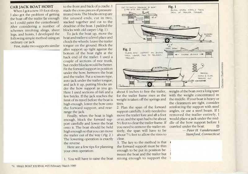

I have now added a copy of an old Small Boat Journal article that showed how one owner would get his boat off the trailer to paint the bottom. I use a similar setup to lift my DS II off the trailer to paint ot if I need to remove the CB. I support the stern on a beam between 2 saw horses and the bow stays supported by the trailer. However, I actually have the entire boat blocked up above the trailer while pulling hte trailer part-way out, then lower the bow back down onto the trailer. I do Most of the jacking using the tongue jack on the trailer, rather than a car jack.

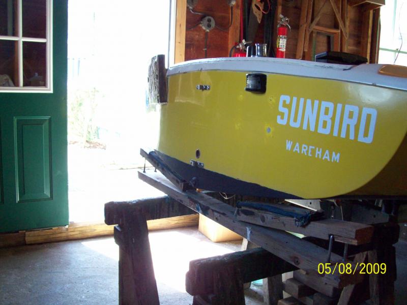

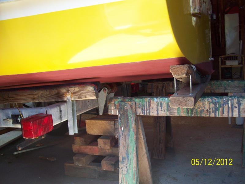

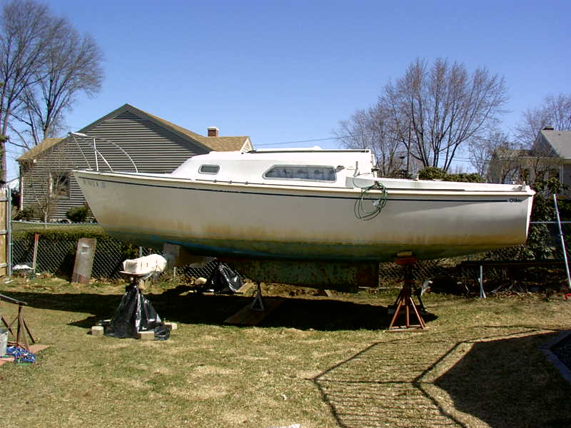

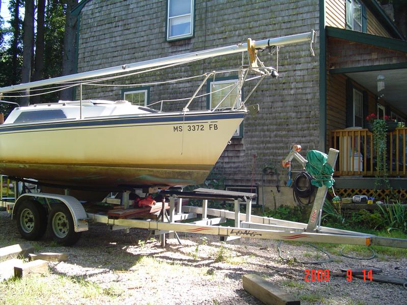

It's possible to shore up the stern of the boat and get most of the hull off the trailer leaving the bow section over the axle of the trailer. In such case I would also still shore up under the bow of the boat and remove the towing vehicle rather than tie it up for any length of time hooked to the trailer. As it is, I would only use a towing vehicle to pull the trailer out from under the boat if the trailer is a complete roller trailer. The stern would need to be roped to something stationary like a tree to prevent the boat from moving as you pull the trailer out from under the Hull.
Getting the roller trailer back under the boat is simple and the tow vehicle is not used.
The trailer is lined up to the bow and keel of the boat and the trailer winch is used to winch the trailer under the boat. The trailer tongue may rise a little but as she gets under the hull it will go down to a more normal position. Of course, the trailer needs to have a good tongue jack with the wheel to roll on. If the ground is soft, place a long 1" X 8" board under this wheel for it to roll on. As long as you have good shoring under the stern that can provide the support needed for the weight of the boat and keep it from tipping over sideways, it will work.
It goes without saying. It dangerous! Anytime you are dealing with weight of this nature there's a risk involved. The boat can tip over and a person can be crushed in the process. Do this at your own risk. If you don't feel comfortable doing it, don't do it and go to plan B, whatever that is.
I'm in the process of putting together a new picture album on this site that deals with taking the boat off a trailer and putting it on boat stands. I should have it complete tonight.

The article you attached describes the technique that I use to move my trailer forward enough to drop the centerboard on my Mariner. It has worked very well for me.

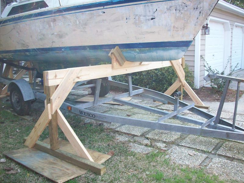

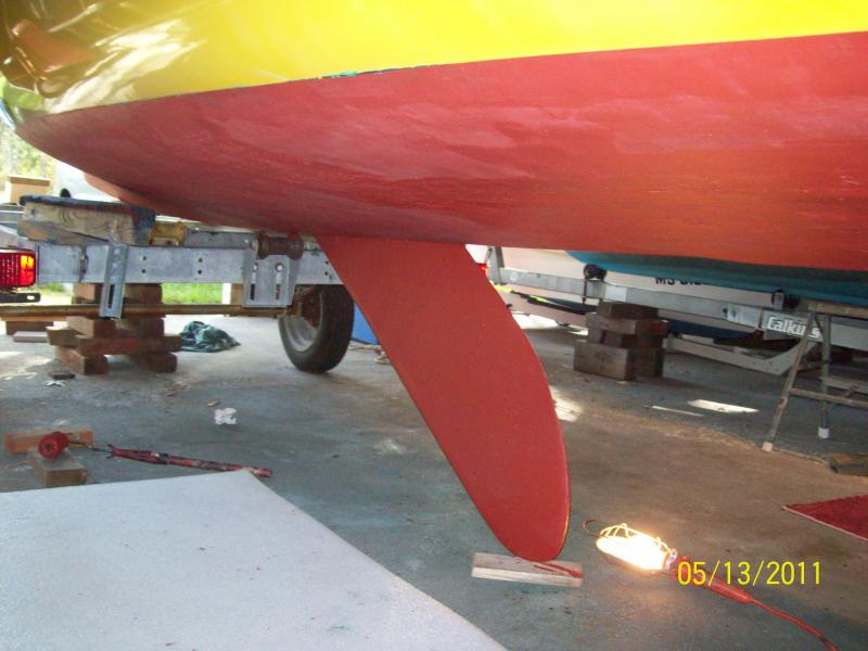

I found a level spot in my yard, dropped the tongue of my trailer as far as it would go, (lifts the back of the boat).
4X4X10' under the tramsom, (10' long gives you jacking room and support room. I jacked as close to the boat as I could and supported on the ends), 2-2X6 screwed together can cut into wedges to block the boat from leaning, (cover all wood with carpet felt to prevent scratches and cracks).
I used a bottle jack and my auto floor jack to lift her up 1/2" at a time, oh, 3' er so. (I had a 2'X2' concrete paver on the ground cuz I was doing this on the grass. Used a 4X4 "pillar" between the jack and the support 4X4.
Once the aft is lifted I used cyinderblocks, wood to hold it in place (making sure the boat was level across the support.
I added a support in the center of the 4X4 under the center of the boat, just incase.........
I lifter the front of the trailer as highas I could, (with the crank and later with the floor jack).
Slid another 4X4 X10' 'bout 3/4 the way foreward, (maybe 1' infront of the trailer wheels), again cut wedges and felt covered.
Lowered the trailer front and rolled the trailer forward to clear the center board.
Was pretty solid.
Lowered the center board, (it was at a 45 degree angle or there abouts on the ground, figured it'd be easy to lower that way than straight up and down, (and I was scared to lift the boat THAT high), and put back). put tape at marks to show leading edge, where the bolt goes through to give me a guide to where to position it back in place,cut the cable, used my floor jack and impact and un did the bolt, popped it out lowered the jack and it kinda sorta lowered/fell out.
Refinished it. I ground it clean, 2 coats West System Epoxy, 4 coats of hull paint, I'm hoping it'll last another 25 years!
