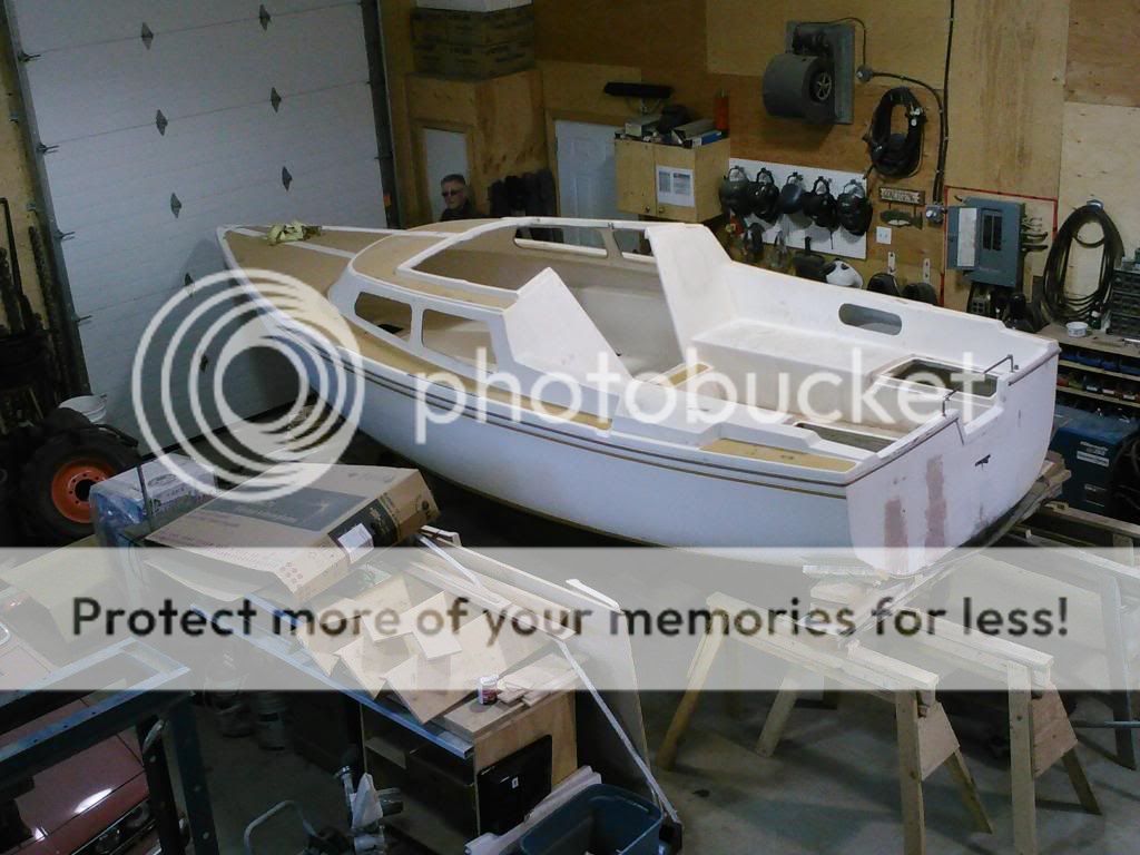

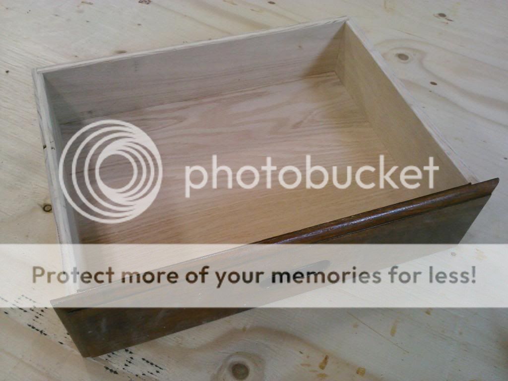

Progress has slowed to a bit of a snails pace since I started working again. But this weekend I sanded down the rest of the keel and applied some West Systems 105 and 205 epoxy and hardener. I also re-built the sliding galley drawer with some oak scraps. Next weekend should be more eventful as we'll be reinstalling the keel, lifting the boat and setting it back on the trailer.

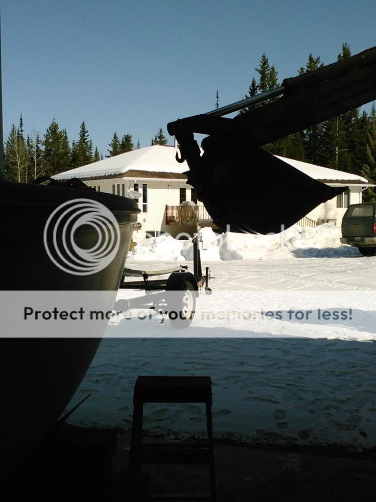

This was a productive weekend. The keel is back underneath, I'll slap some bottom paint on as much of it as I can next trip. We also had the neighbour reach his backhoe into the shop to lift the bow and return the trailer. So I was also able to pull it out and wash it in preparation for painting soon.

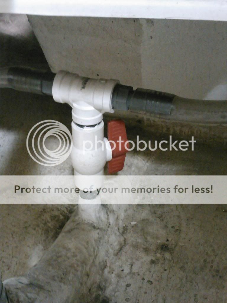

Here is my new scupper plumbing (I'll add the pipe clamps later) and break winch. Its not coated in zinc but I won't be sailing on saltwater anyways.

Gotta say you are doing a great job redoing that boat. Enjoying the pictures and updates on your boat. Interesting way to get the keel back up. Just wondering if anyone has mentioned or did you think about using a big truck transmission jack for that? Seems like it would be so much easier. Thinking if I drop mine I will try this. One thing is for sure you will have a solid boat when you are finished!

We used what was readily available to us. My father's neighbour is a logger and has some heavy equipment at his house and was willing to help us out so the backhoe was our best option.
We learnt a few things while reinstalling the keel and pivot hardware that I thought I should pass on. Once you get the old bolts out, chase the threads with a tap to make getting the new ones in a little easier. The pivot pin is the right length but the hanger and SS bushing are both a little oversized (at least for my boat). I ground the bushing a 1/4" shorter once it was installed, curved most of the edges of the hanger, sanded a little bit off of the inside faces, and bore the holes 1/16" larger.

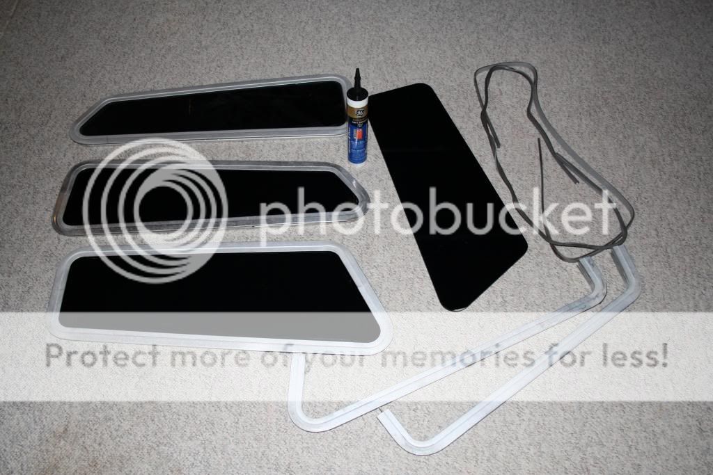

I haven't posted any photos in a week so here is some new eye candy. I've been slowly cleaning up and tinting the windows whenever I've had a few minutes with nothing better to do. Its surprisingly easy, I can't believe I was going to pay someone else big bucks to do this for me. Just cleanup the glass as well as you can and follow the directions for the tinting film. Once they're all back together I'll re-silicone the glass to the frames with some black door/window caulking and I'll probably use butyl tape when I reinstall them in the boat.

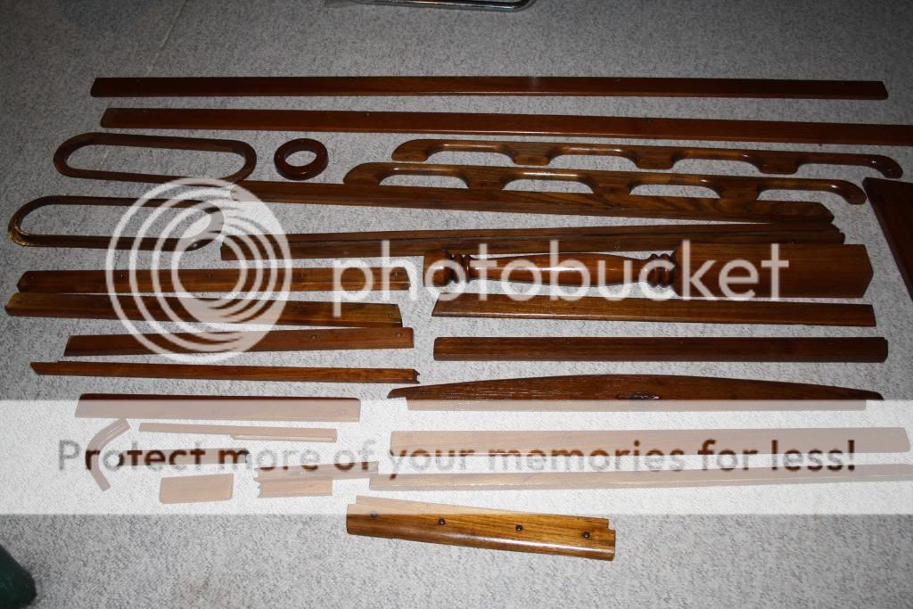

I was also a bit lazy about showing off all of the teak that I sanded down and re-oiled last fall. Considering that its all 40 years old I think it looks pretty good... at least from this vantage point.

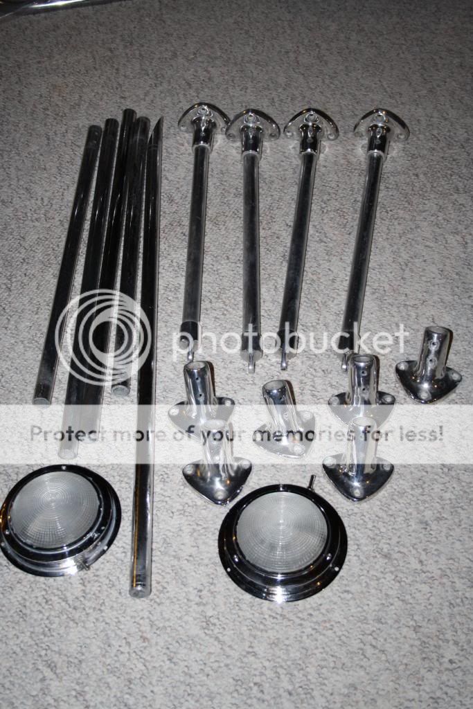

Nearly all of the stainless and aluminum is polished now including the bow and stern pulpits. I did go out and buy an electric buffer but most of these were done by hand. So far I've burned through three 141g containers of Mother's Mag and Aluminum Polish plus some other stuff that I had laying around that didn't work as well. You can sort of see how dull they used to look in some of the earlier pictures or in post #18.
