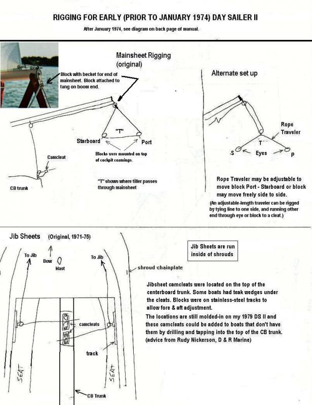

Here is the diagrams that I have in hte DS II manual that I created. Not exact, but close enough for the MARINER. Also, several pics of the original mainsheet on the 1972 (and older) Mariners. I have a good pic of a later Marienr mainsheet (1974-78) as well, they used a mid-boom mainsheet rig. Picture is, again, of a DS II, but rigging is basicallt the same for mainsheet.
Not sure how much help the Mariner pics are..... but I tried!

Thanks! I have the jam cleat at the trunk with 2 pulleys. I just had to reposition the springs to the plate to make the cams work again. I have the pulley at the boom end and pulleys at the transom. I returned the boom vang and brought a pulley for the mid-boom. The boat was fitted with a forward boom vang but I think I will just haul the boom down at the mast and that will simplify things.
