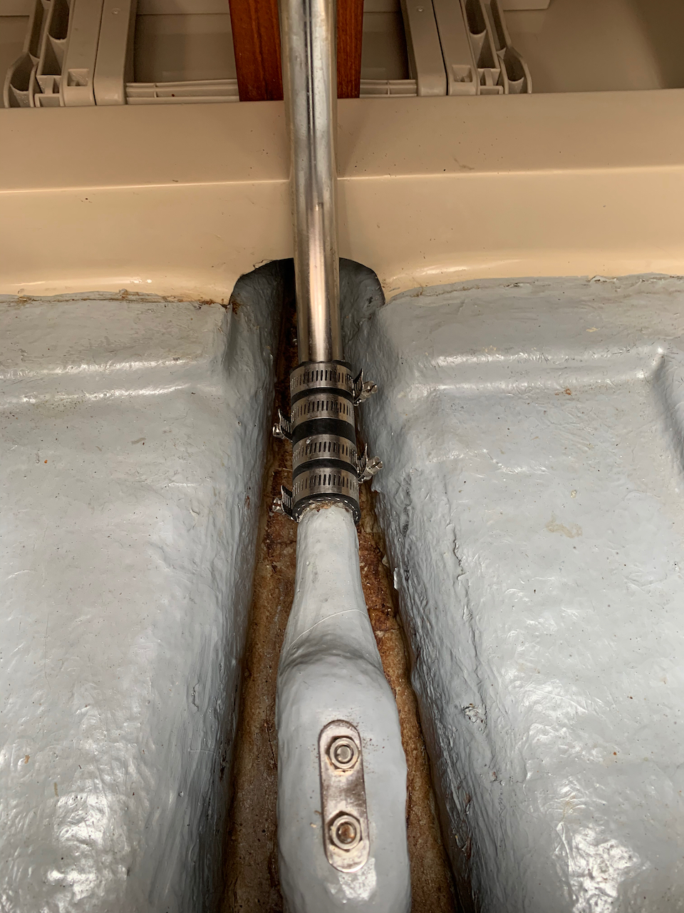

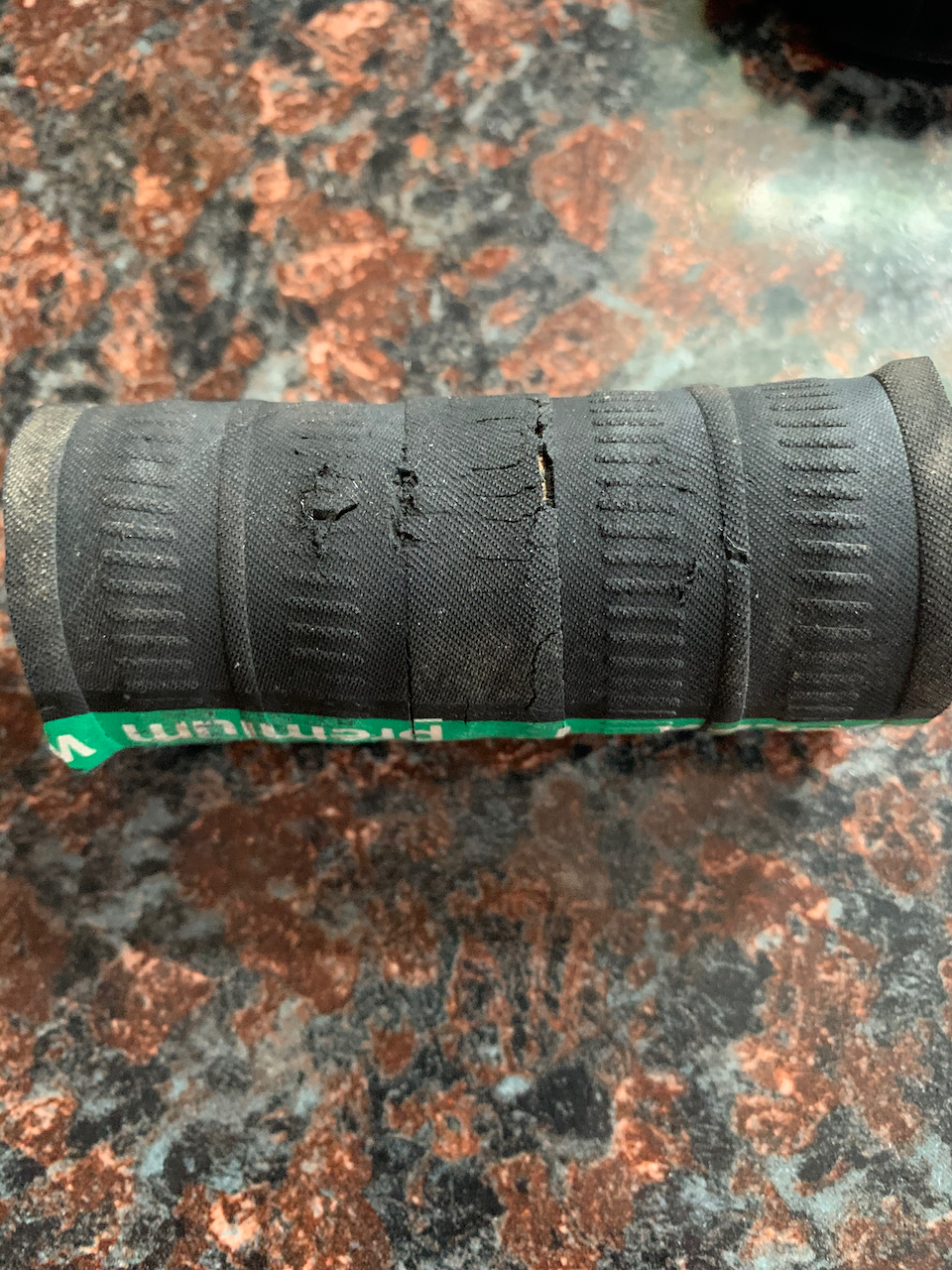

I do not know if this is below the waterline or not, but I would guess that it is, or is very close. Given that it uses 2 hose clamps per side, I'd say it's below waterline. I replaced mine on the trailer last spring using some hose sourced from a local hydraulic store. Original was wire reinforced sanitation hose, same as the cockpit drain, and I had some on order but it hadn't arrived, so I went to the local hydraulic parts store. The guy there looked at what I had and brought me that hydraulic hose as a replacement, and I think it's fine, because it's a short, straight run. (On the cockpit drain, I think I'd rather use the wire reinforced sanitation hose, because it bends 90º, and the wire would prevent collapse at the bend, allowing faster draining. I have heeled far enough to ship water over the coaming, but not on the regular. Unlikely I'd get pooped, but still, having the fastest drain possible in the cockpit would be a Good Thing™) On my boat, the vertical tube just pushed up into the barb of the bridge deck fitting. Since I did mine on the trailer, it was pretty easy to run the centerboard line. The original was probably fine, but it was getting surface cracks in the rubber, and I didn't want to chance it, especially given my general low level of anxiety based on the whole pandemic thing, so I went and did the job. I pushed the hose farther on to the SS tube, then worked it back over the barb on the centerboard trunk, then refastened the hose clamps.

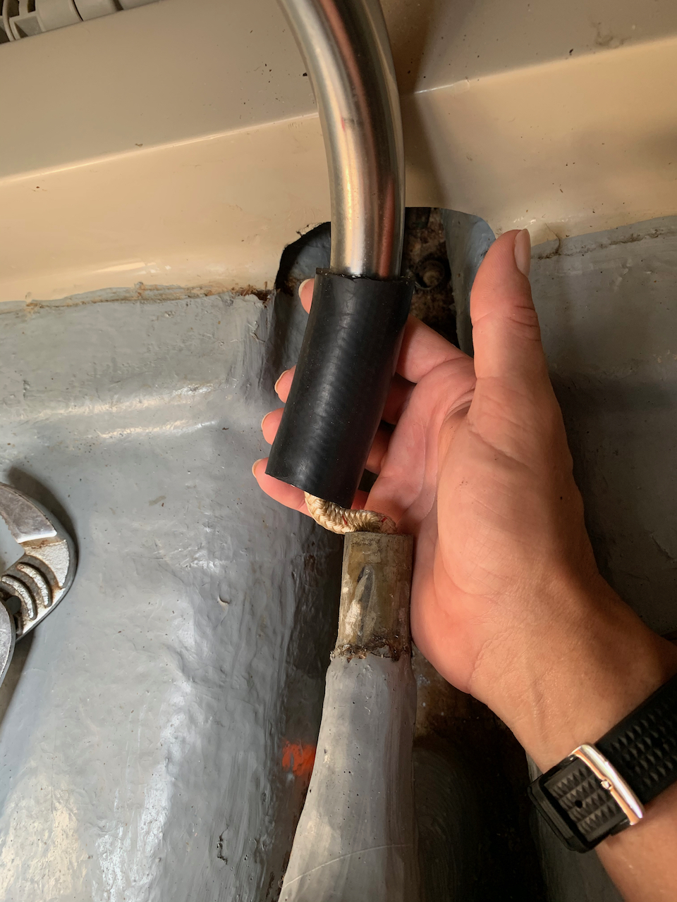

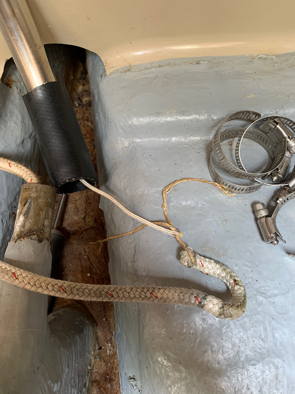

Thank you Brian for the detail! I’ll post a pic next time I get to the mooring but oddly my vertical stainless tube is strait (no bend at bottom) and stops above the bilge cover requiring a longer hose and the hose to bend 90 deg. I wonder if previous owner cut it for some reason?

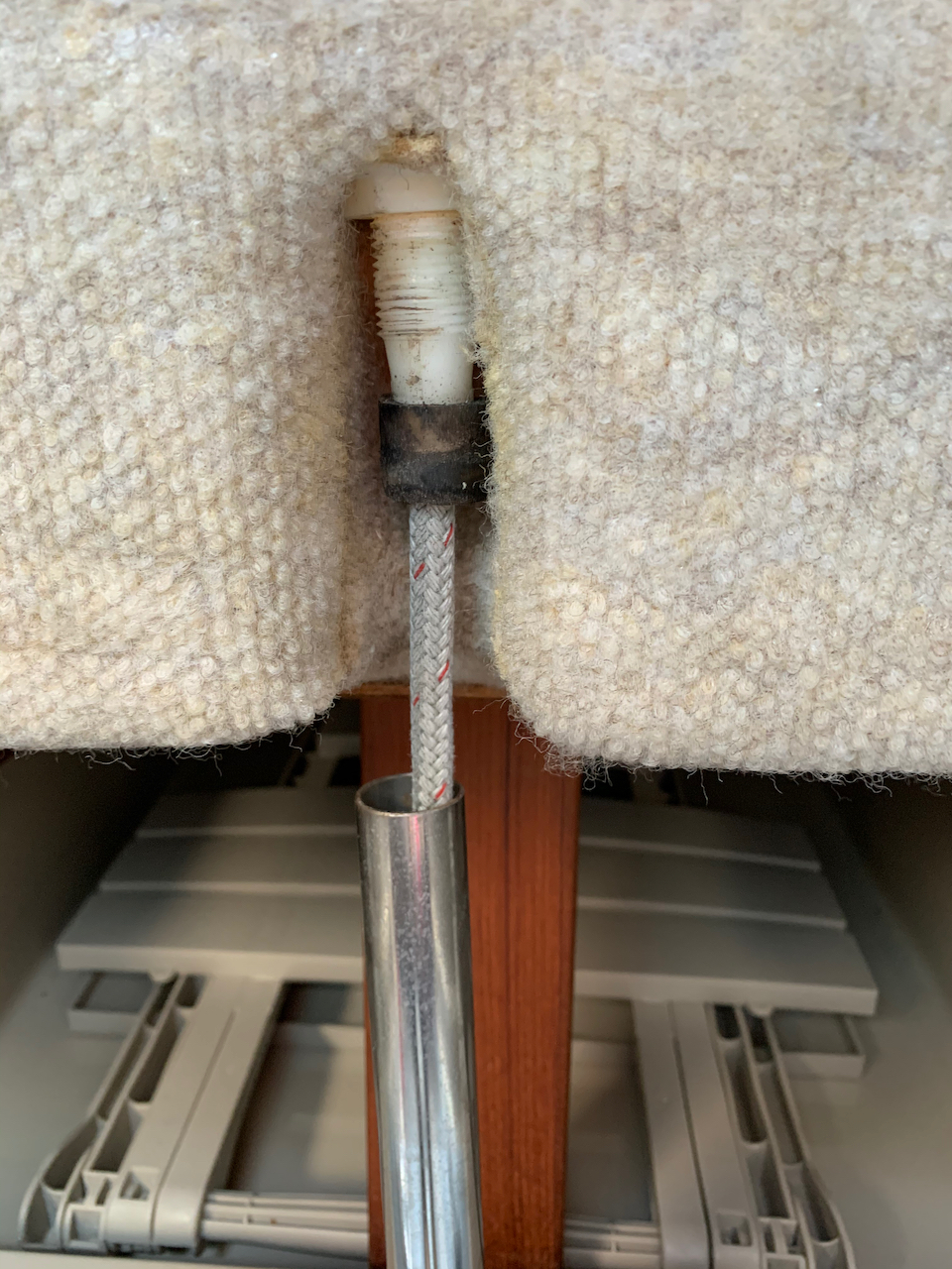

For now I used some As Seen on TV flex tape to seal it which has worked however now I noticed when I am out in wind and bashing waves water is shooting right out the top of the pennant opening in the cockpit which must have a bad seal as I find some of that water running down the outside of the stainless tube in the cabin. Way less than was coming in the hose to stainless joint but def have some more work to do here….
Aug 26, 2020
17
oday 192 Three Islands Mallets Bay
Well I pulled out the plastic fitting in the cockpit the line goes through and used a liberal amount of boat life caulk. Now I can bash waves in 15-20 and my bilge is BONE DRY yay!!
