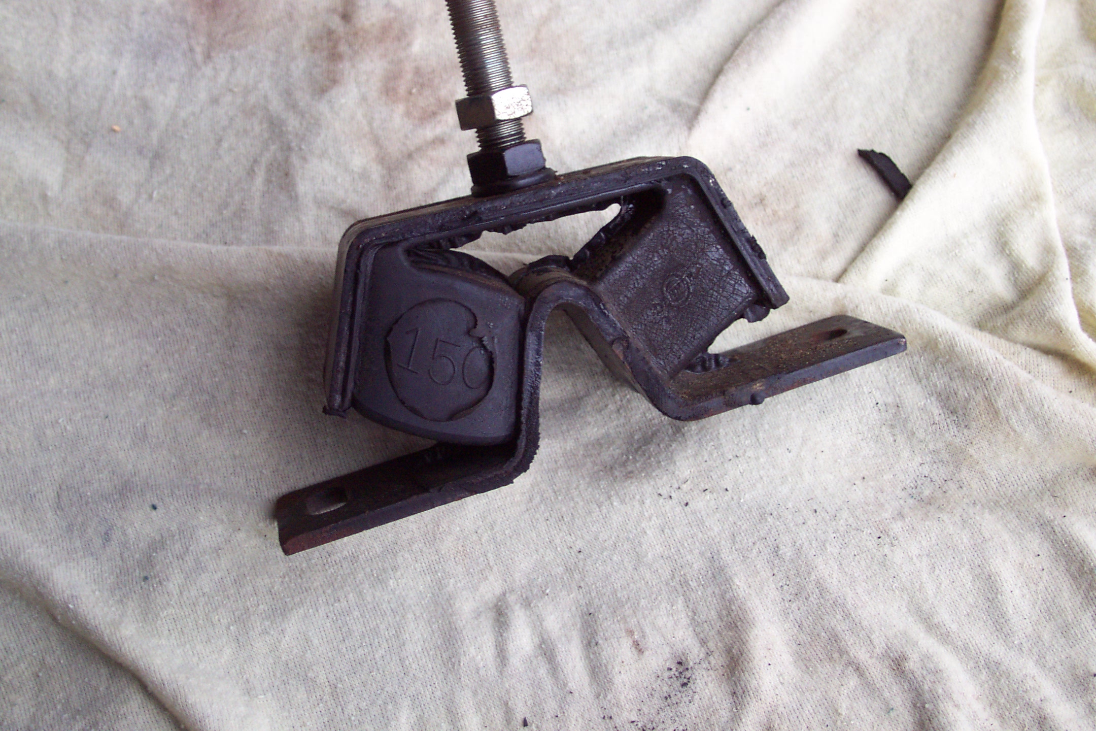

The picture shows one of the engine mounts replaced in my boat about 5 years ago. The yard recommended replacement based on the fact that the rubber is bulging on the left side in the picture.
I am not sorry I did the change out but did not actually notice any improvement in vibrations.

Technically, you should re-align your engine to the shaft if you replace the mounts. Quite a bit of work, so "if it works don't fix it!"
