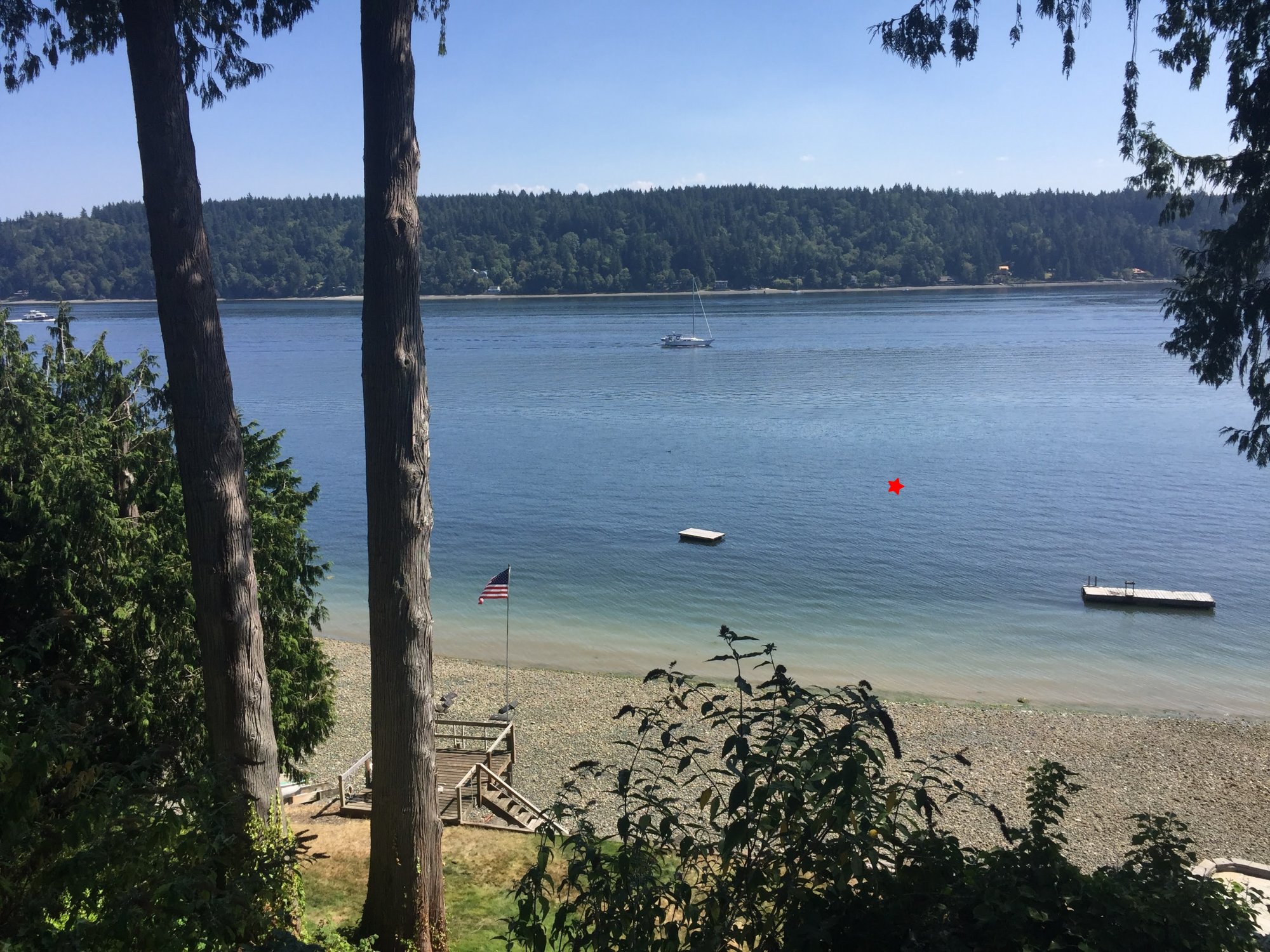

What about buying a 200 ft (est) extension cord and running it from my dock (with flag) to the mooring (where the red star image is shown) and running the 20amp AC charger?

Rick that is an interesting idea. Granted limited folk might swim through the area. Perhaps you might find a few salmon float to the surface which would make interesting meal opportunities.
You are joking right?
12,820
Sounds good on paper, however, its implementation would be fraught with both danger and other problems. The consequences of an AC leak into water can be lethal. While AC lines are run under water to provide power to islands off shore, they are considerably more robust than an extension cord and their locations marked on charts.

Yes. It was mostly a joke.
My dock neighbor did this, not with one cord but multiple 12awg plugged into one another. He did the best he could to seal the connectors. I still shook my head and vowed to never swim in that part of the marina
12,820
And the marina didn't throw him out? Electricity in fresh water is very deadly, a little less so in salt water.
This end of the marina is like the wild west. They don't seem to care what you do but dont don't expect them to actually fix anything. They're floating docks that require a dinghy to get to
