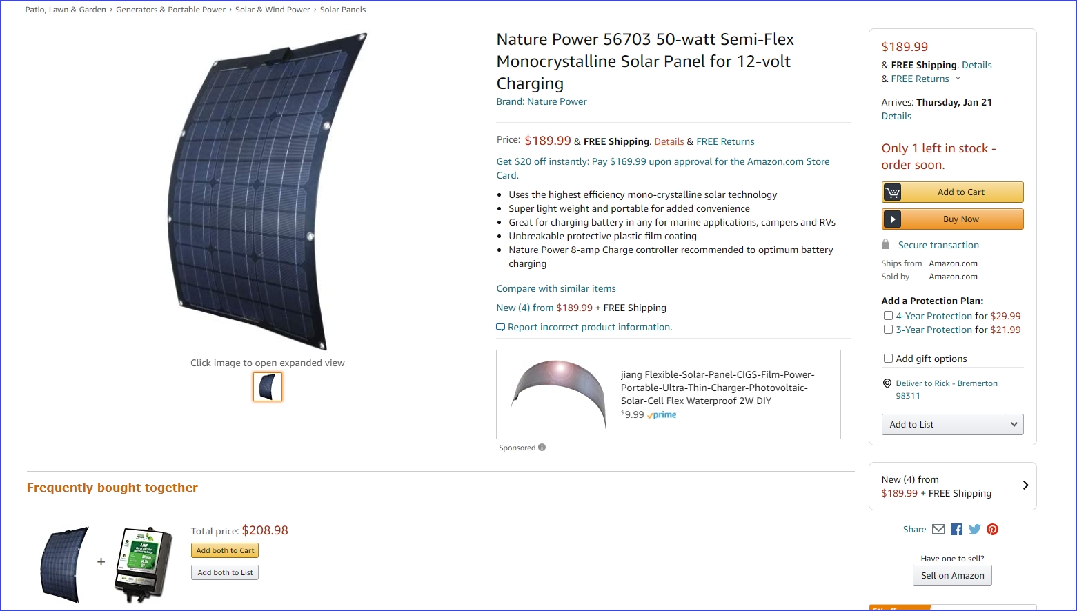

Now I'm thoroughly confused.
I don't need to run the cold-plate system. I don't need to run anything. The boat will have a float switch added to the bilge pump before it moves to the mooring, but since the bilge water level has not changed more than 1" in 2 months I'm not very worried about sinking on the mooring.
There is no way for me to charge at anywhere near 0.1C ( 10% of 184ah or 18.4 amps) with any size solar panel that I would be willing to put on the boat. I have some limited charging from the Honda 9.9 but it's 6 amps at WOT.
If the batteries are 100% charged when I move to the mooring, is the 1-2 amp (25 or 50w) panel with the regulator enough to meet the trickle charge and keep them at 100%? Something like this image?
It seems like my uneducated assumptions that the AGM was a better choice, was a fool's decision. Sounds like some basic flooded (cheap) batteries might have been a better choice given how the boat and it's batteries will be used.
No one likes to waste money, but $600 is a a small amount really compared to the other costs of ownership. The AC charger will take care of them for 6 months of the year, and maybe a basic solar system will not "kill them to fast" during the other 6 months.
We have a blue-top AGM in a 20' Whaler that is going on 4 years old and we have taken pretty poor care of it based on what I have read here. At the marina it's had a AC trickle charger, but during the winter the battery was fully charged before storing it in my garage and then pulled out 6 months later - charged up and installed in the boat. Seems like it should be on the smart-charger all winter in the garage.
Is spending $200 more for a solar system worth doing or should we just treat the 2 banks badly like the Whaler and hope we get 4+ years of use out of them by only charging when the Honda is running for the summer ?
