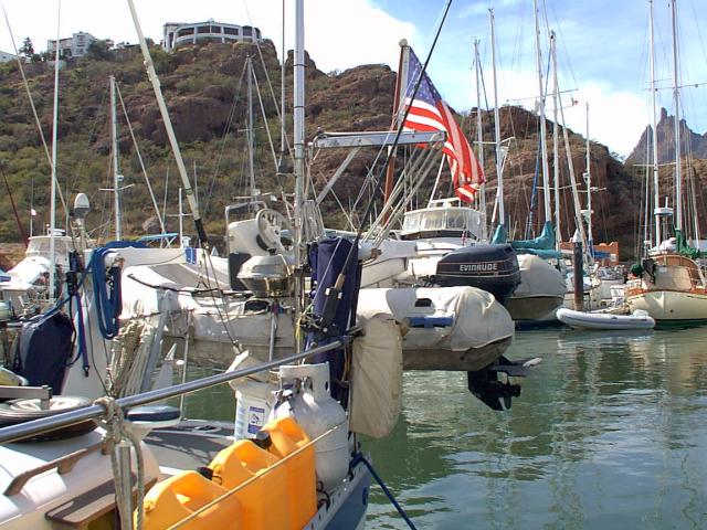

I have a 10'3" Caribe with a 15 HP Evenrude and a center console; and I carry it in davits on my 37' Center Cockpit. I needed the weight because my Perkins 4-108 was replaced with a Light Yanmar 3HM35F and the loss of weight affected my tracking. Never-the-less I got heavy duty custom davits by Holstrand with two 1500# electric davit winches to lift it easily. Unfortunately at 10'3" it is 1'3" less than my beam I have still accidently bumped it on Piles maneuvering around docks. The other problem I have had with it is the weight. I have grounded it on sand beaches to go ashore as the tide went away, leaving me with one heck of a job to get it back in the water. Adding wheels did little as they too sunk in under the weight.

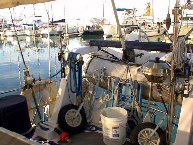

Busy stern, I like the dinghy cover. Does it keep her dry?
Bob S
Jun 13, 2005
559
Irwin Barefoot 37 CC Sloop Port Orchard WA
Bob S: it is busier than normal. The dinghy wheels, fishing poles, and the bucket are usually not there, but most of the other stuff is. The cover on the dinghy is referred to as "dinghy chaps" and is primarily a sun cover over the inflated tubes only. Those pictures were taken in Mexico where we spent 6 years cruising the Sea of Cortez.

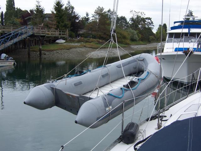

The picture is of my Avon 3.15 roll-up which I stow on the coach roof, deflated, and with the transom folded first and then the bow over the top of the transom, then lashed down. The 8hp Johnson, 56 lbs, will get us on a plane but at WOT it sucks quite a bit of gas. Most of the time I putz at slow speed. I have had runs of several miles to reach a fishing area but that is infrequent. I think something in the 2hp to 3hp range would be more practical and I've been checking Crag's List for a small outboard but this is not the time to do it.
