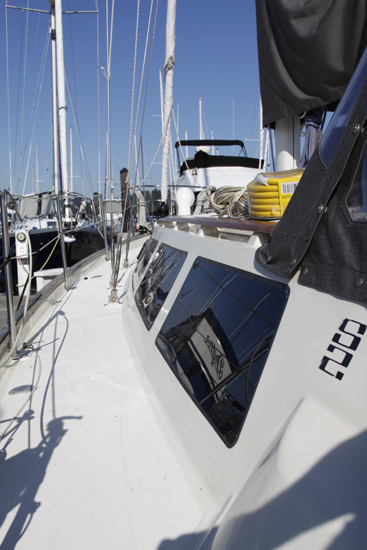

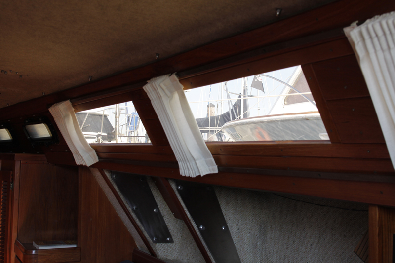

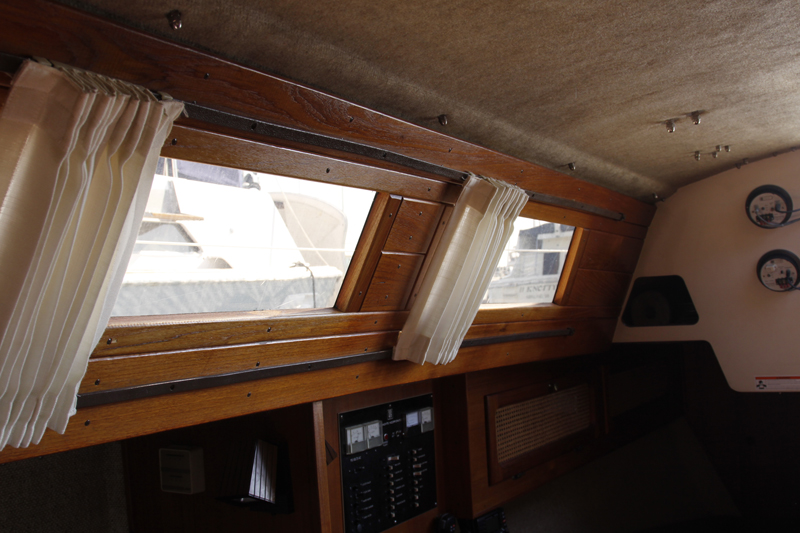

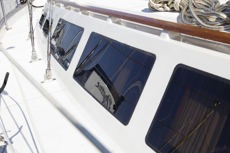

Ok.. Some have been asking for some pix of the new windows.... I finally took some. However, I don't know how to upload on this forum. Help???

Sorry been busy winterizing. When you post a reply you should be looking at a box with emoticons on one side and buttons on top as I see it typing this. There is a camera on the top right hand end of the row. If you click that it will bring up a second window letting you browse to the files to upload.
Hope this helps!

I agree. They look great. I need to do mine, but the to do list is quite long!
