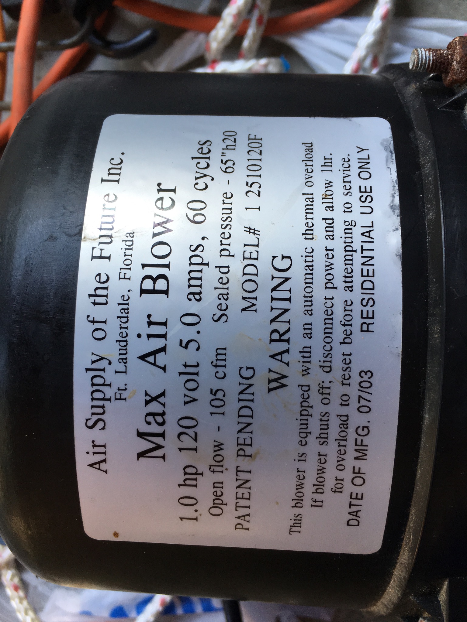

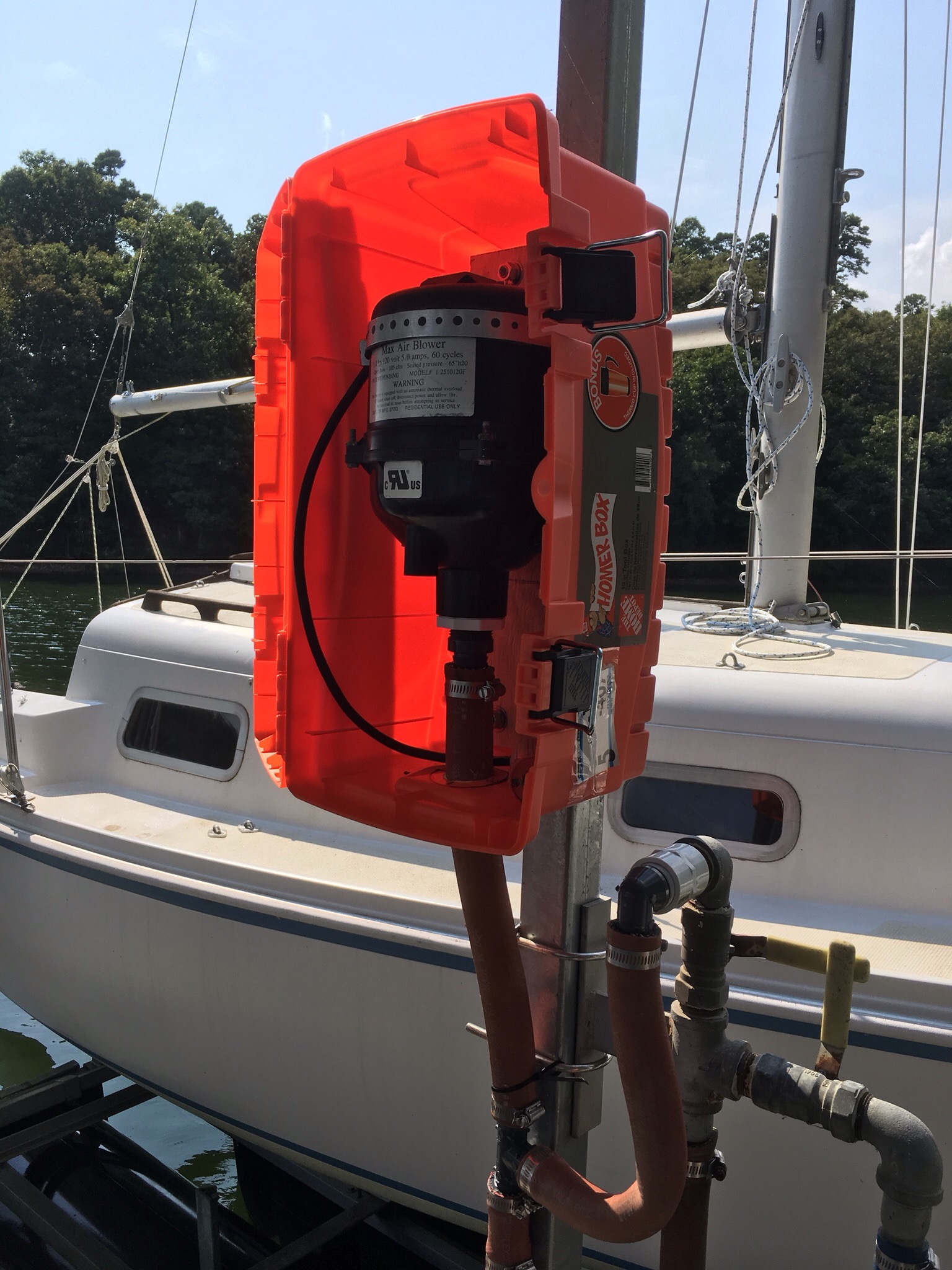

I've replaced the old lift blower motor that burned out. It had been made from a vacuum cleaner blower and had been in use over twenty-five years. I replaced it with the blower motor shown in the photo below. It works great.
I mounted the blower in a six dollar plastic tool box I purchased from Home Depot. The box protects the blower motor from the sun and rain.
We currently use a generator to power the lift motor, but plan to add a solar system within a few months. Total cost of solar system ( solar panel- $120.00, controller-$20.00, batteries-$185.00, inverter-$180.00, mounting hardware, wire, and switches-$60.00 ) That's quite a difference from our first solar powered boat dock solar system which cost us $3,500.00 back in 2004.
I added a second air valve so we can control air flow separately to the center lift tank we added last fall.
