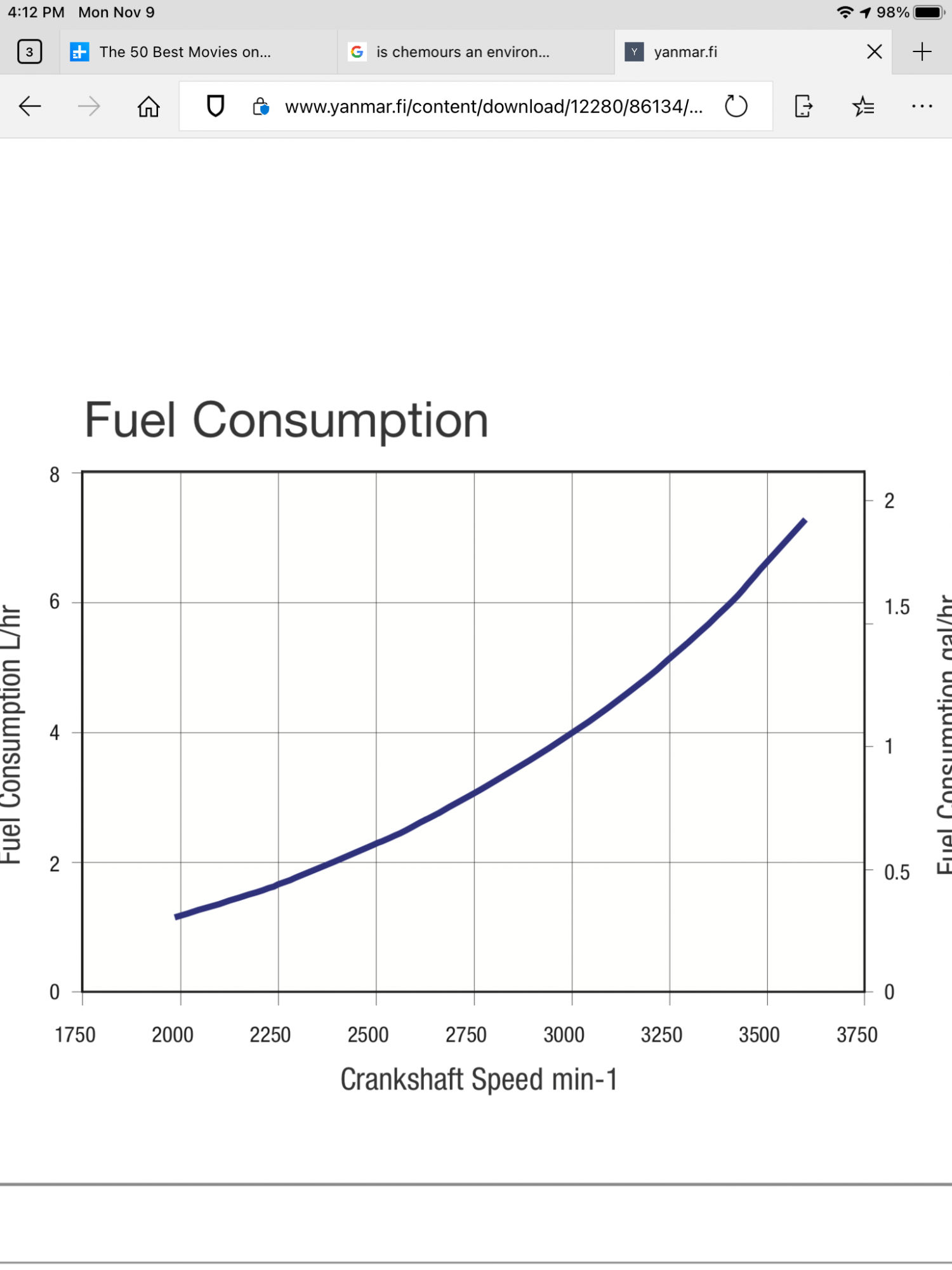

My boat has a 3YM20. My boating is a mix of day sails and long cruises. I log my fuel usage and hours on every fill up and it have never seen a burn rate as low as 0.45gph. I usually cruise @ 3000rpm. I average about 0.8gph. This corresponds fairly well to Yanmar's published curve. Of course, my burn rate varies quite a bit depending on how I use the boat. I think it is best to be conservative, I would hate to run out of fuel in the middle of Lake Huron.
