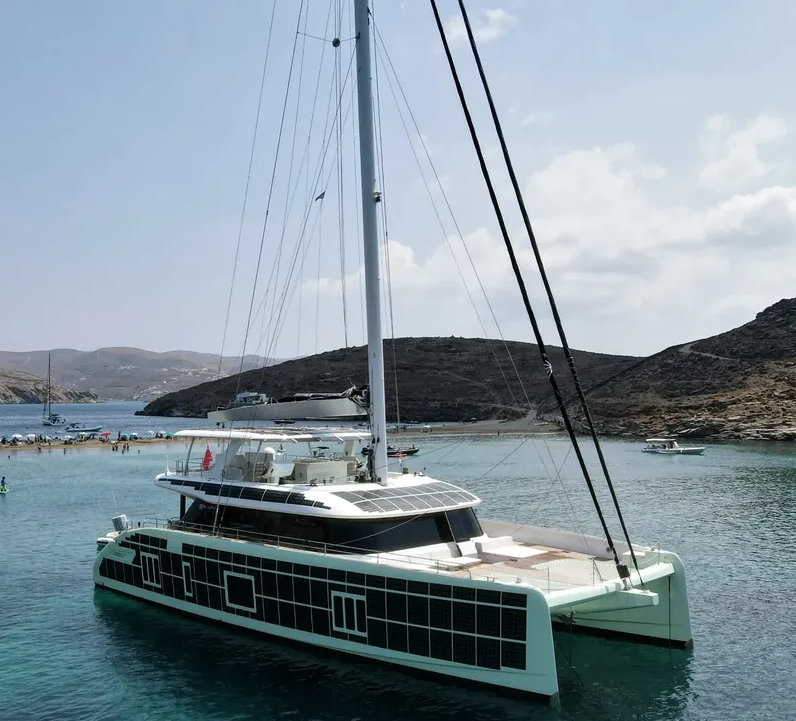

One more thought - this was one of the boats struck I mentioned with that LDP. My advice is that if you are going to permanently epoxy solar panels all over your boat hulls and decks, you do not want to be any place where a lightning strike might happen. The strike ran through all of those panels, and they now have to be removed/replaced. The boat got repaired just enough to motor away, so I don't know what is involved with repairing the rest of it.
