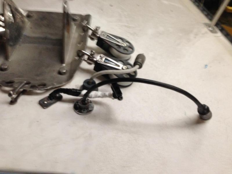

Routing the wind transducer wire... I used micro C through deck connectors, and spliced the simnet cables.. we'll see if it worked.  The wiring inside a simnet cable is identical to NMEA 2000, the connectors are just different.. I just needed a solution to allow me to disconnect the transducer for trailering.
