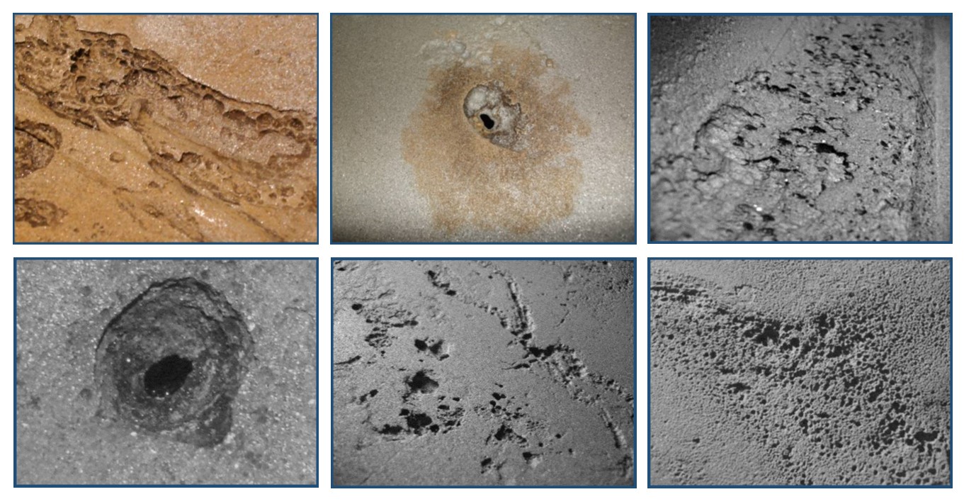

Examples of pitting corrosion, all from inside fuel tanks (steel and aluminum). The normal cause is a concentration cell resulting from sludge deposits. It is by far the most common cause of failure in fuel tanks.

[Pitting Corrosion]The normal cause is a concentration cell resulting from sludge deposits.
:plus::plus:
Cause is loss of passivation of the metal under a deposit.

Pitting corrosion - see the NACE data dictionary I attached in the previous thread. Here is the definition of pitting: localized corrosion of a metal surface that is confined to a small area and takes the form of cavities called pits. However, it is commonly stated if there is lots of corrosion, and it is manifested with lots of pitting, to be called pitting corrosion. But really, it's just general corrosion exhibiting pitting. There are many other forms of general corrosion...
Crevice corrosion on the other hand, is a defined term in corrosion studies. See the data dictionary:
crevice corrosion—localized corrosion of a metal or alloy surface at, or immediately adjacent to, an area that is shielded
from full exposure to the environment because of close proximity of the metal or alloy to the surface of another material or
an adjacent surface of the same metal or alloy.
Note the main difference between crevice corrosion and pitting due to general corrosion, is that in crevice corrosion, there is a surface that is shielded due to close proximity to something else. Also notice that Collier talked about "Poultice Corrosion", and gives an explanation of the type of material that may be shielding the metal.
The difference between crevice corrosion and pitting is that in crevice corrosion, which typically starts as a pit, there is lack of exposure to the environment, hence there is a reduction of available oxygen. That does not allow fo the passive oxide film to re-form at the bottom of the pit, hard to do in any case, but more difficult when there are restrictions in oxygen flow. The bottom of the pit becomes more acidic, corrosion generates hydrogen, recall, how many hydrogen ions is the definition of how acidic something is. This then promotes more corrosion at the bottom of the pit, which then sets up a vicious cycle and you get an ever deepening pit, or in other words, it grows into a crevice. So you're correct, most of the time in the areas you've mentioned, there is a propensity to find crevice corrosion, although you can find just pitting also.
