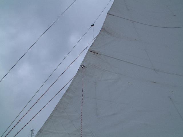

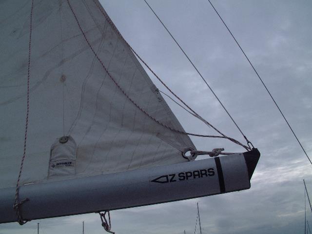

Here are a few pictures that show the OEM single-line reefing. The reefing lines are the white with red stripes in my pictures.
The first reef line is tied on the stbd side at the aft-most ties point under the boom and goes vertically up the stbd side of the main sail and through the large eye and then to the port-side block at the end of the boom. It passes directly through the boom and exits at the gooseneck. From there it goes vertically down to the top sheave block on the port side of the main sail, then up through the metal mast loop to the turning block on the mainsail and then passes down through the metal loop on the mast again to the bottom double turning block at the base of the mast. From there it passes through the under-deck organizers and to the port side sheet stopper.
The second reef is rigged exactly as the first above except that the port and stbd sides are switched.

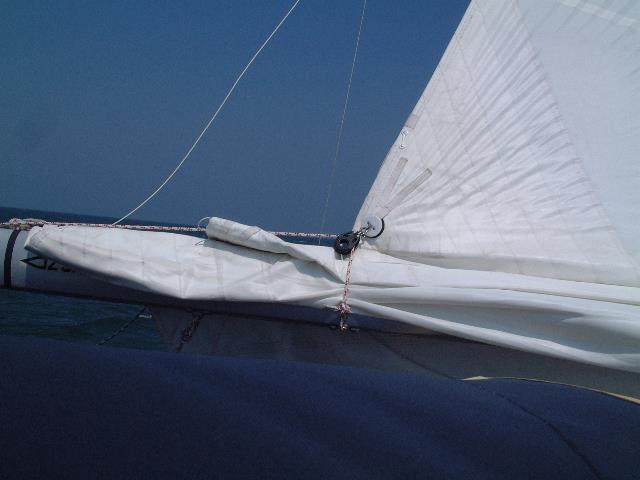

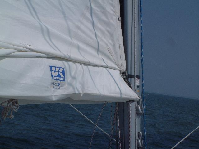

Here are a couple pix that show the answers to your questions.
The block attaches to the luff of the main sail and hangs from the stainless ring that is sewn and reinforced at the luff. The routing of the reefing lines is as I described in a previous post.
Regarding the outhaul- The two different sized lines is normal. Inside the boom is a 2:1 or a 3:1 (not sure which) block system that gives you the ability to pull the outhaul very tight to stretch the foot of the mainsail. On my 40.5 the outhaul line (red/white) exits the bottom of the boom and then runs to the cleat that is mounted on the bottom of the boom. My outhaul never goes to the base of the mast or back to the cockpit.
FWIW, I also installed a block at the leech of the sail to reduce the friction where the reef line passes through the cringle. That was a dramatic improvement over the standard OEM setup. This is shown in the last photos. I think there is now a roller device that is marketed that is inserted in the cringle. At the time I set this up, I could not find an off-the-shelf solution. So I machined two sets of Delrin disks that fit together from each side of the cringle and were screwed together. A center fitting that could rotate was the attachment point for the leech block.
