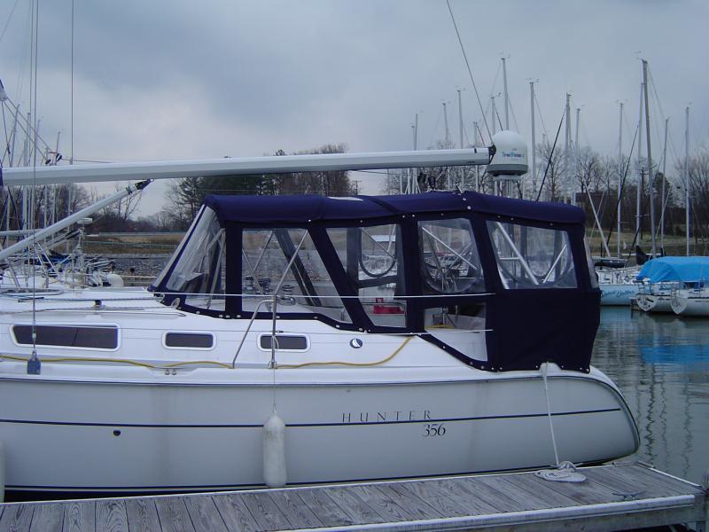

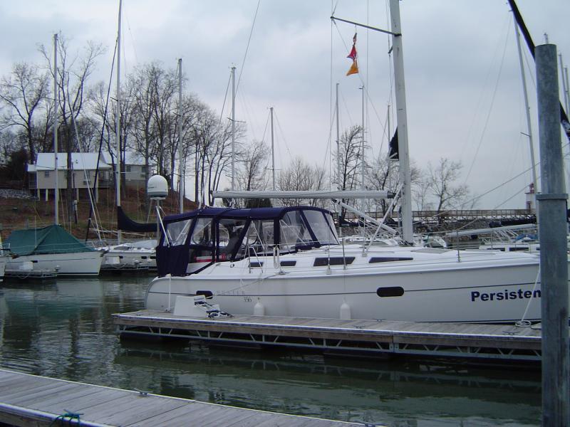

I have stratiglass on the dodger and side windowns but my rear enclosure is regular vinyl. I rinse with water and then let dry. I use rubbing alcohol on a dry terry cloth rag. It cleans and doesn't degrade the plastic or stratiglass.
I am finishing my ninth season on the dodger and enclosure. I keep the enclosure on from mid October to late April, so it is on about half a year. The dodger stays on all year.
I use a silicon spray on the zippers. I don't think it is ideal, so I am looking for an alternative. I just put my enclosure on last weekend and dry zippers and cold vinyl make it a tough job. Once it warms up in the sun, it is a much easier job.

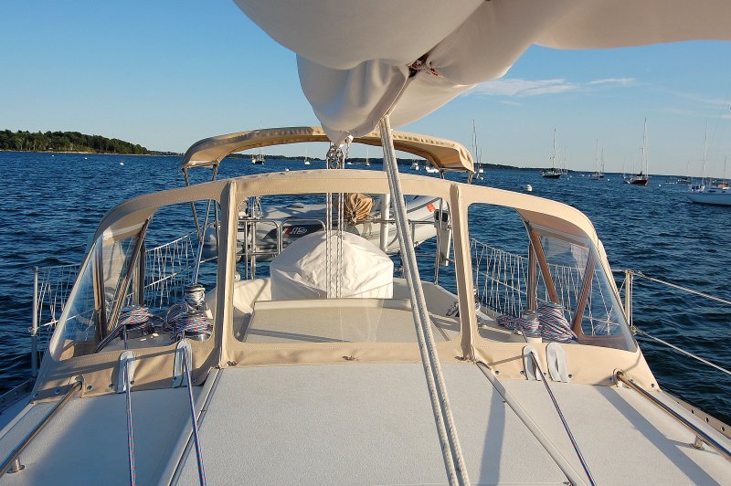

I use IMAR products and won't use anything but. I use 303 Aerospace on the zips but nothing seems to help over the long haul and I've tried Riri, YKK and black and white. Black holds up slightly longer but looks bad with light colors....

Damn, Maine Sail you keep a fine looking ship! Is there no schmutz, no algaed line, no chipped, mildewed fiberglass aboard that you can share?

re. Mainesail: a boat that clean suggests a sick mind.

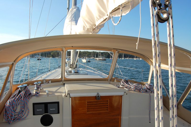

What I want to know is, who made that interesting take on a fiddle block on your boom? I've never seen anything like that before, at least not on a sailboat.
Edit: Never mind - it's Garhauer, which I don't normally see since they're not in my local West Marine. Schaefer has a couple sort of like that (3-sheave), but not hollow, air block types.

Yep Garhauer and about 1/4 the price of Schaeffer, Harken etc.. great stuff, excellent warranty and they will do custom work for you too.
Installed a rigid boom vang on a 53 footer this summer, for another forum member, and it was still under 1k for a 53 footer!!! I think he said about $750.00 or so. Beautiful piece and it fit like a glove but that was mostly thanks to the owner sending a great template of his mast & boom.
