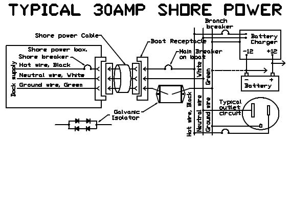

If your Spur is 1/4 left and the zinc is gone you have serious grounding problem. First of all, dieconnect any DC ground from the bonding ground (keel etc.)
Use a volt meter and measure the shorepower ground to the motor. The zinc doesn't eat itself. It is the current flowing between your shorepower ground to the drive shaft. Have you heard of a galvanic isolator? You can make one youeself with 4 diodes.
