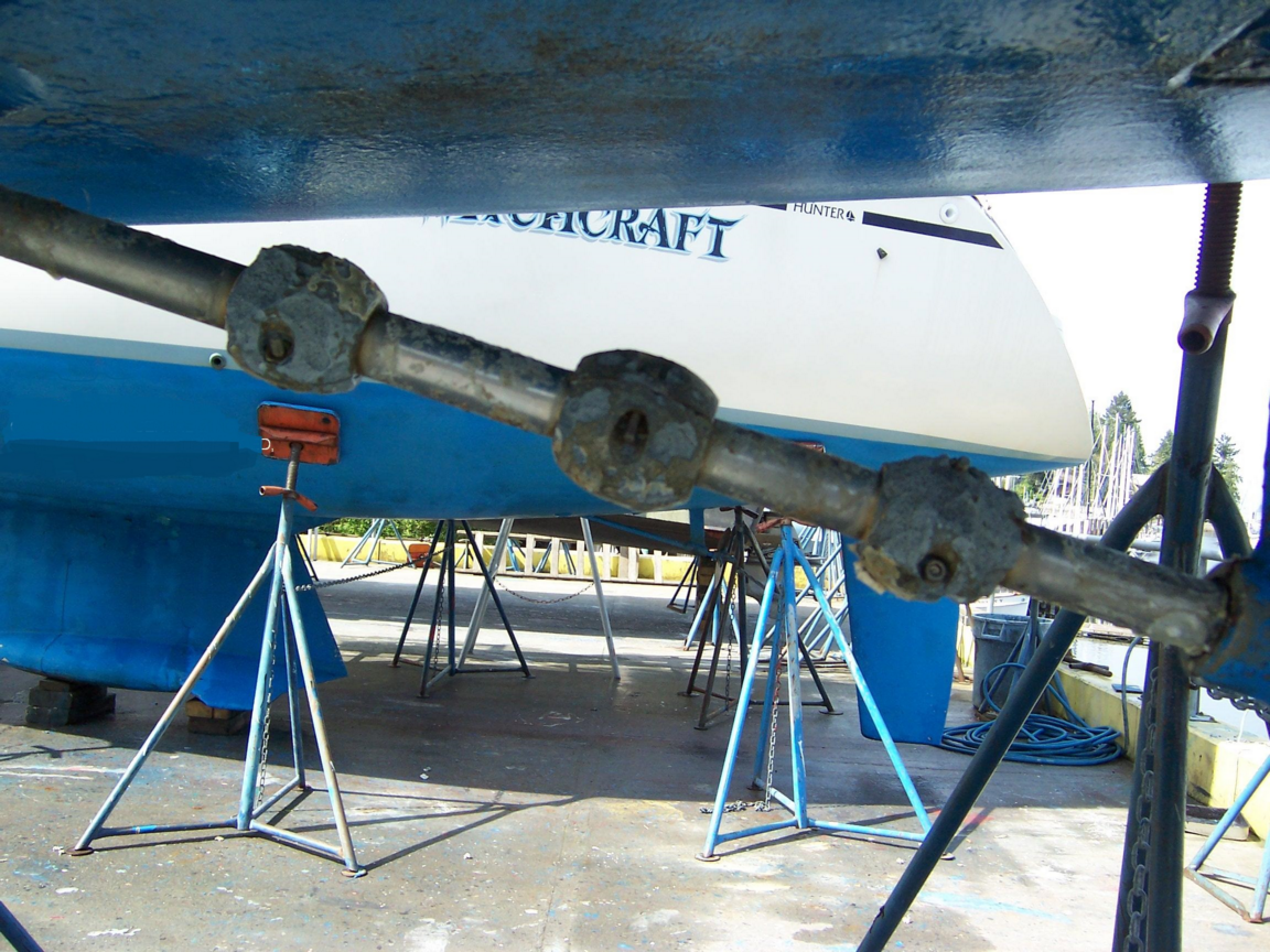

Here is a picture of a Hunter 35.5 with 2 zincs
1991 Hunter Legend 35.5

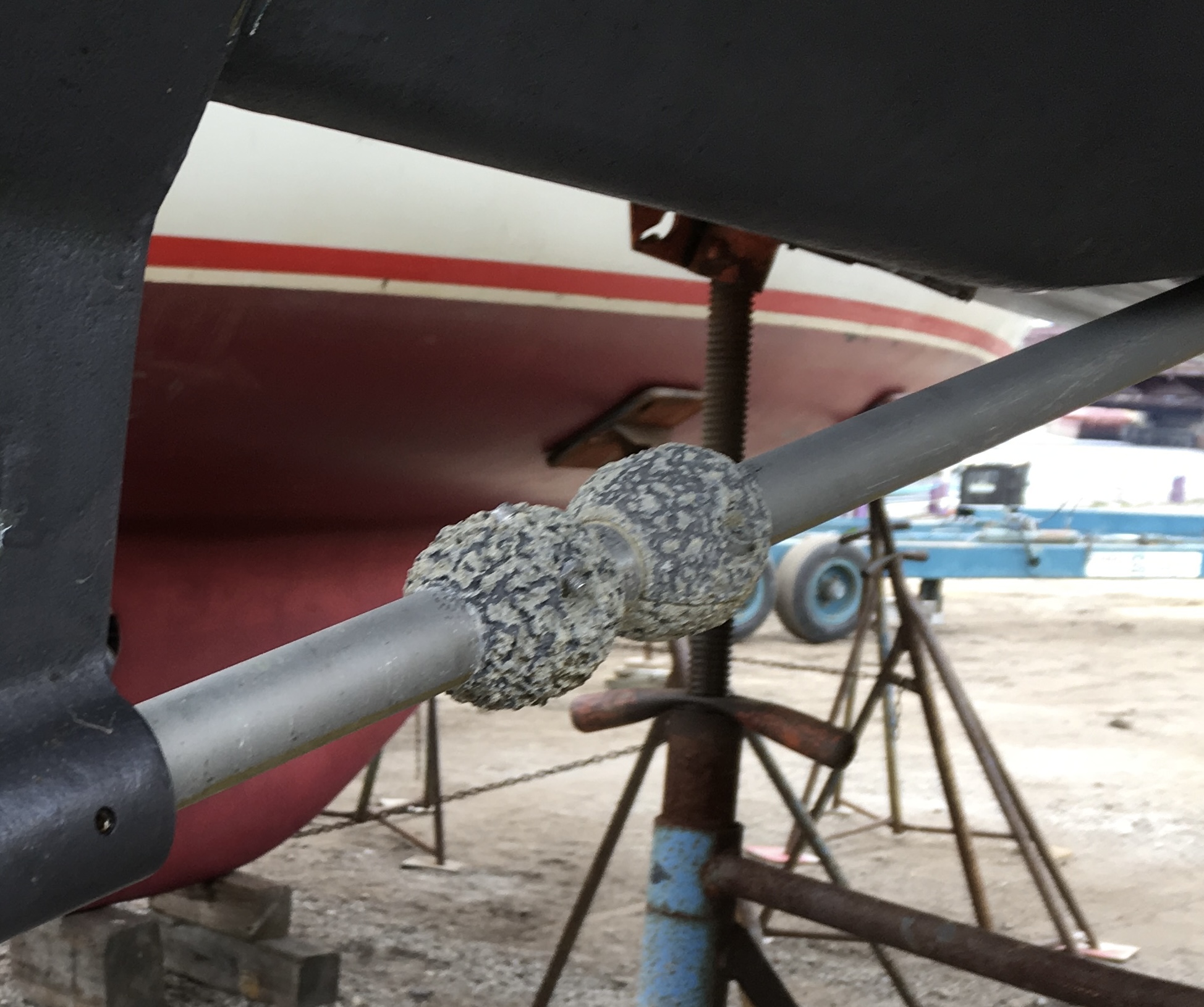

I’ve been following the MarineHowTo best practices on shaft anode installation for years, with one exception. I have not bothered with protecting the integrity of the anode around the bolts. The bolts are countersunk into most shaft anodes, if enough of the anode is eroding for there to be an issue, then you need to replace them more often. Perhaps also trace and remedy the cause, install a galvanic isolator, etc., but I’m digressing.
I keep two magnesium anodes on my prop shaft and replace one of them each year. My boat is on the hard almost half the year, and on shore power (with a galvanic isolator) at the dock during sailing season. It splashes in the spring with one new anode and one installed the previous year. They usually look like this at haul out.
