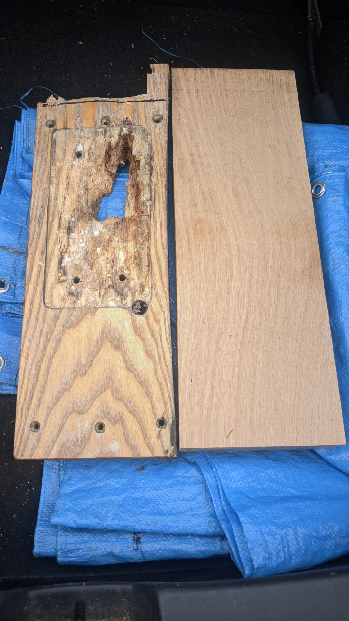

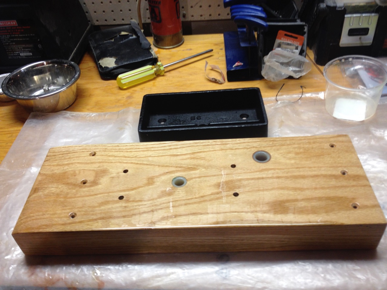

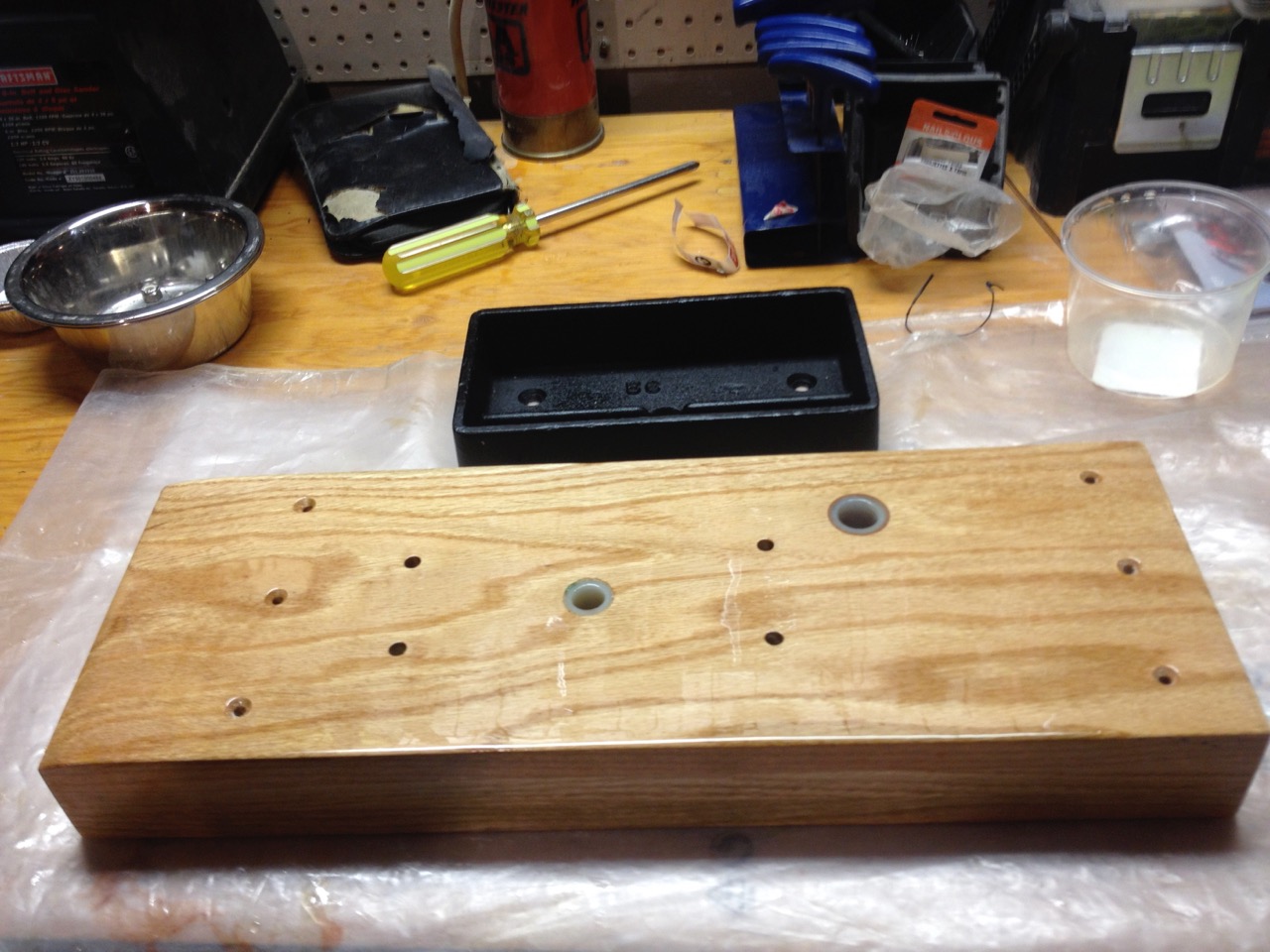

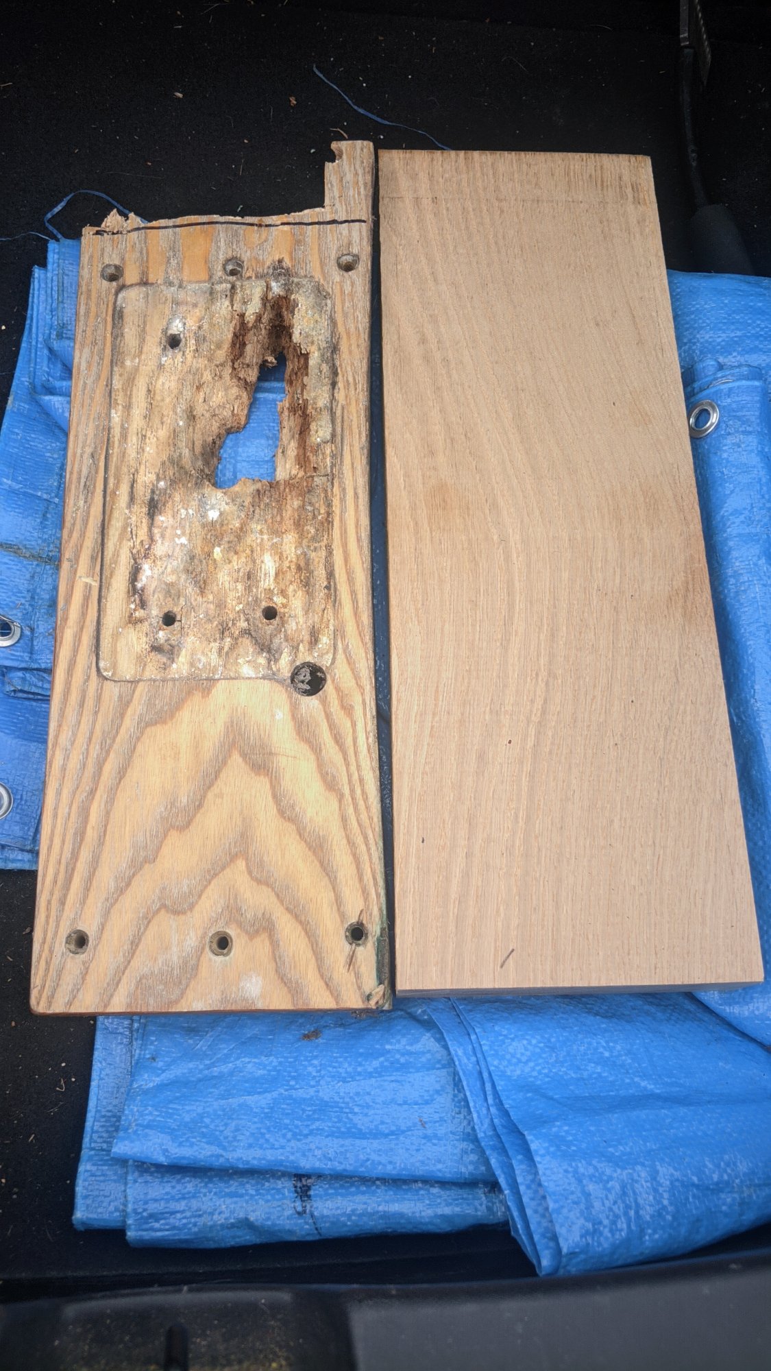

It is 3 "layers".. the aluminium "pan", a thick piece of hardwood (visible under the aluminium pan), then the stringer/step section. The stringer/step section would rot.
The thick wood block section that the original aluminium pan sits on, has a drain hole so the water can go down the mast, into the pan, through the hole, and into the bilge.
Mast needs to be pulled to check both the stringer/step and the wood block above it.
On my boat the previous owner had a custom aluminium piece made in place of the stringer/step section 20 years ago. When I bought the boat, the thick wood section that sits on that, had rotted around its drain hole.
I made a new one that is fully encapsulated in epoxy. So now it is bulletproof.
The deepest part of the bilge is under the step. Because of that, I have an ultra safety systems float switch hooked to a rule dry bilge diaphragm pump. The non-submersible pump is self priming, and sucks the water out of that hidden spot with a hose and can suck almost all the water out. They spec 1/8" or less.
