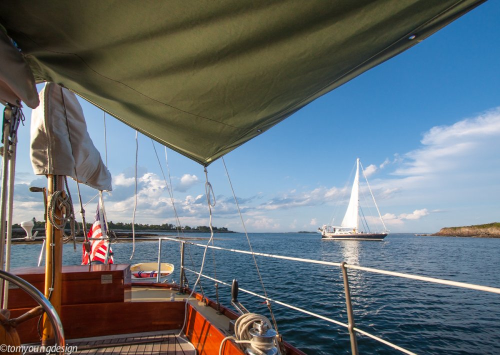

These poor folks came into the anchorage at Jewell Island with their partially reefed mainsail. They anchored and then I realized, they couldn't douse their mast furled main.
It was a good move as the anchorage was calm and the winds had dropped off. We watched, helplessly, as for over an hour the crew wrestled with the problem.
Even a light wind on a big luffing main is stressful. They worked hard! In and out a few inches. They kept squinting up the sail track toward the masthead where I assume, the bound up area was.

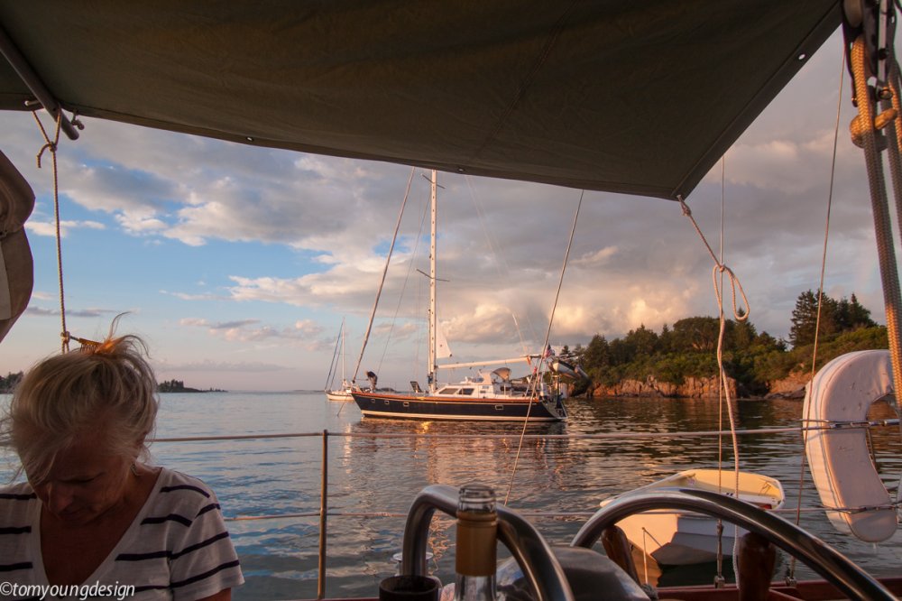

It took over an hour of intense work, but they finally cleared the problem, and the sail disappeared into the mast and went silent. Phew...
The irony is that the boat looks like it's equipped for the opposite; easy sail handling for stress-free sailing.
