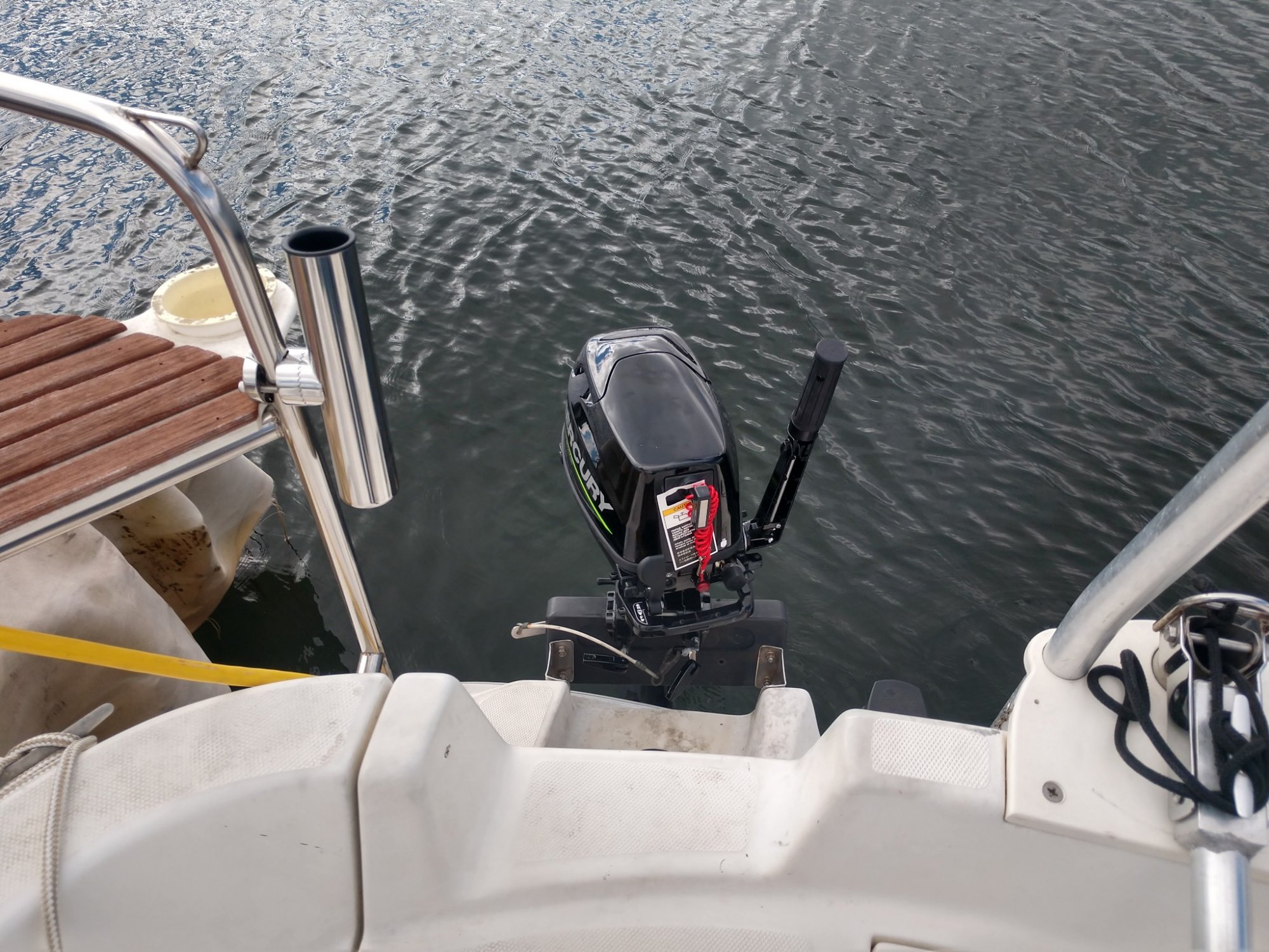

I love mine. Though last Sunday it refused to start. I have had it for two years and nothing would convince it to fire up even after 40 pulls. We headed home only to experience a strong pop up thunderstorm. Monday I went to the lake with a new spark plug. I pulled the starter rope before I did anything else and it started on the second try! It must have been providence that kept us from going out the day before. The outboard saved our lives.
We have had our Mercury Sail Pro for two years. The only issue I have noticed is that after the first year it took more pulls to start. But it always started. I have heard three explanations on causes including remedies. I have tried none of them.
1. Tap the pressure regulator a few times. 2. Replace the spark plug. 3. Turn the propane tank upside down to introduce liquid propane into the engine. The theory is that the liquid propane is an excellent solvent. I have not been able to find a shop manual. I may have to order one from Tohatsu as they are the manufacturer.
I also found recommendations online recommending adding a filter to the propane line. They are common on forklift trucks.IMG_20211108_145841896_HDR.jpgMercury on Transom.jpg

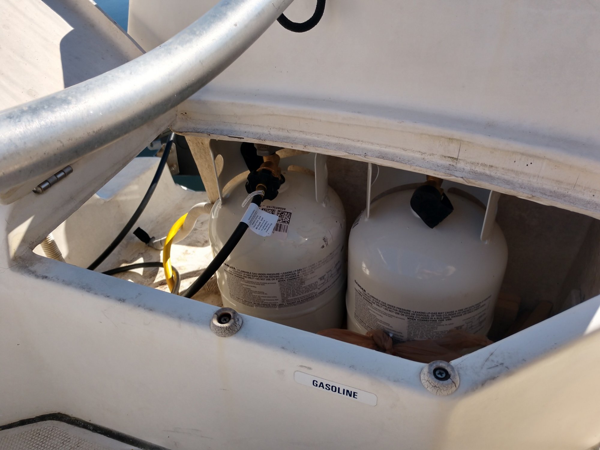

I was lucky on my H240. My fuel locker holds two 11 lb tanks. I use about 1 tank a year.
