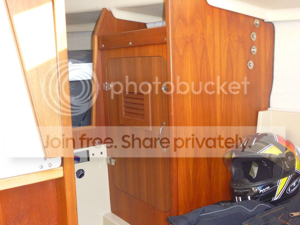

Here is how I changed the clothes closet into a useful cupboard.
With a jig saw, cut out the weird shaped opening to a nice rectangle with rounded corners, lay a piece of 1/2" marine plywood against it and mark around the opening with a Sharpie. Cut out the door and sand all edges. Add a couple of hinges and a ball snap then add a hook like the folding door.
Add a shelf or two and bingo, it's done.

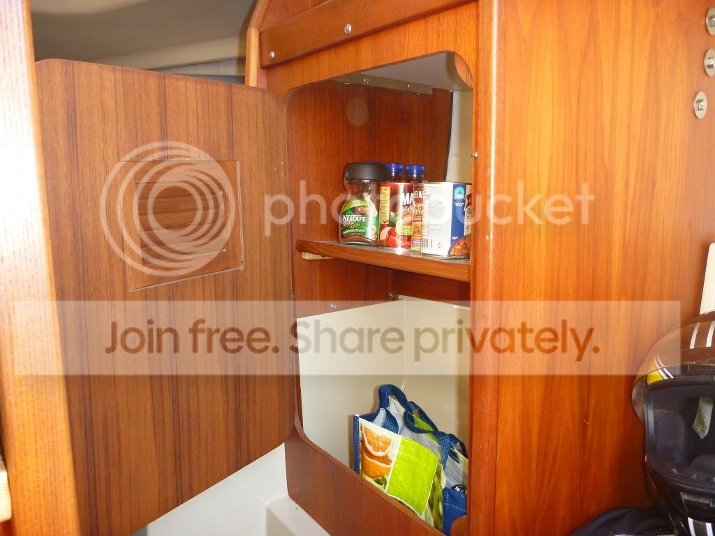

The added shelf holds tons of canned food and other kitchen stuff
