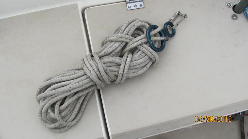

It's a DIY boom break. I got this idea from Wayne last year. He had built his own version of a Dutchman and he wasn't satisfied with it until he got the idea of using a "Super Eight" mountain climbing device by Black Diamond.
I used a Black Diamond mountain climbing ascending device called a Super Eight that I bought on the web from some place in Utah last year, two single sheaves, a twisted shackle for the Super Eight to hang the right way on the boom eye strap, and a long length of 3/8" non stretch braid line.

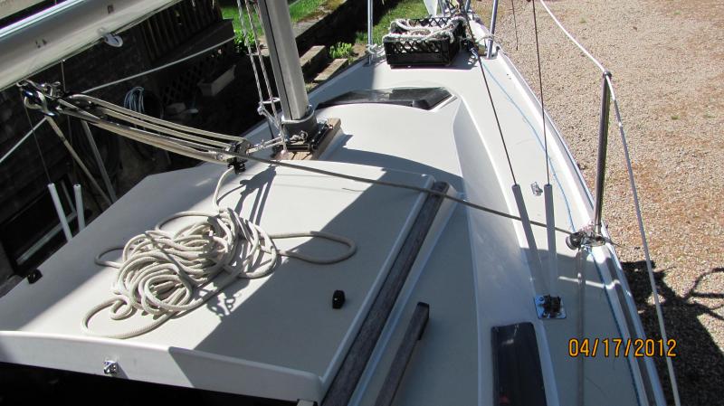

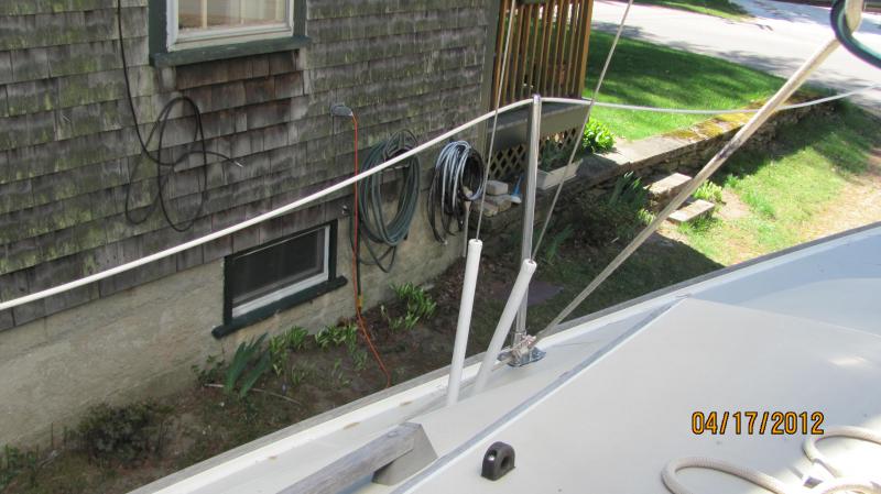

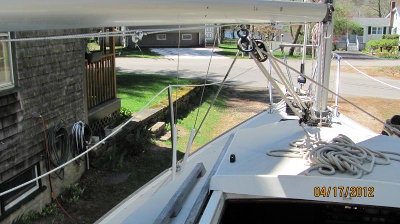

I tied the sheaves to my lifeline stanchion bases just forward of the chainplates and I'm using my stern horn cleats to tie off the braid line. I'll have to pick up a couple of small stainless steel shackles from Lowe's or "Worst Marine" for attaching the sheaves to the bases, but the 3/16" braid line will work for now. You need a boom vang to make this set up work. I tried it out today and it seems to work. More info on this mod can be learned on this site:
