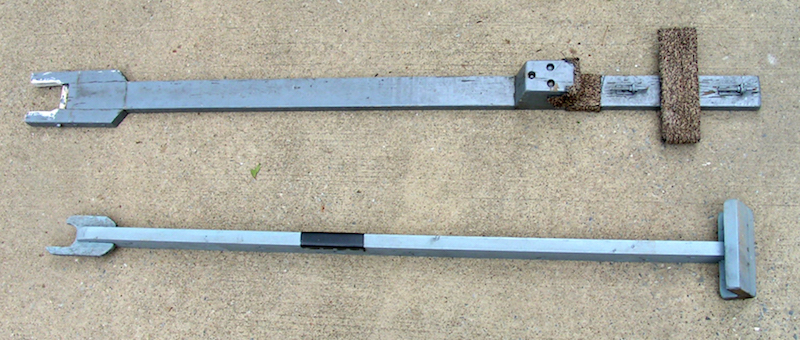

Mine is one piece with 2 sets pintels, square aluminum about 2.25" light weight and very strong. When at the ramp I set the mast aside lift the crutch then set the mast on top the crutch. It rolls very easy when I walk the mast back. has worked great so far. I can lift the crutch to the higher position from inside the cock pit no problem. IMO I would not use wood.
Sep 30, 2013
3,720
Mine is one-piece wood with two sets of DIY pintles. Or, more correctly, three pintles total, which allows for two height settings. It's simple and I like it, it's been working like a champ for almost two years. I have no plans to change anything. I don't employ any side-to-side bracing, although I do throw a long bungee over the mast and down to the pulpit on either side.
My pintles are made of a piece of stainless angle with a bolt through it. "Hard won advice": don't try to use aluminum angle! The first pic below is what I have now, the second pic is what (quickly!) happened to the "beta" version I made, using aluminum angle: :eek:

$tingy: Good to hear. I was also concerned about sliding the mast back when stepping it. When fully extended, that crutch is a very long lever, and it wouldn't take much pressure on the top end to damage the pintles. Straps would solve that. Just leave them attached until the mast is up. Not to mention, in my case with the custom rudder, it would hold the rudder from moving. One thing I like about modifying that motor mount support for this use, is that it has an internal shock absorber. Hopefully I'll get time today to go see one for real. All the ones I've looked at were not usable because the actual cradle meant for the motor is too small for the mast. In this model from Reese, the other ears on the end, which are meant for attaching to a trailer roller, look to be the right size. Hopefully a small roller will fit between the ears.

piedpiperIII: I saw the photos you posted. It was one of a few examples I found with dual pintles. Interesting about not having issue adjusting height from the cockpit.
I was basing my concern on the fact that I have the 1/2" pintle upgrade on my boat and you have to work the rudder back and forth to get it to seat in the pintles. As the bushing wear though, it should be much easier.
Thanks for the advice !

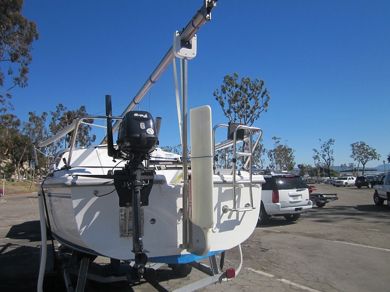

FWIW, Here's another option that totally eliminates the concern about the pintles. It's on a Seaward 22, but the same concept would work on the C22 if you had the pushpit. My concern about that setup is simply it's size/complexity. It's easier to stow a long pole, than a large T shaped system IMO.

Or, simply get the Rudder-Craft adjustable mast crutch designed for their rudders. Slips on, slips off, no tools required....
By the way, a GREAT company that is one of the major supporters of our upcoming C-22 National Regatta. They have also come out with a neat maintenance free mast support that fits on the bow pulpit when trailering.
