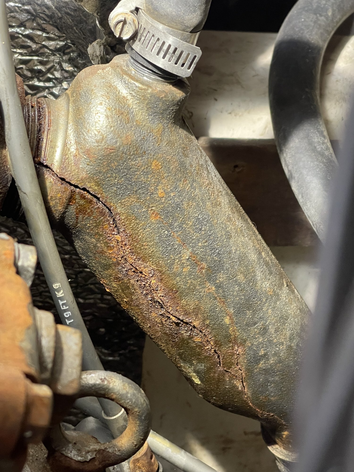

Yenmar 2QM15 Exhaust Mixing Elbow Part PIC INCLUDED
Apr 3, 2023
8
Hunter 33 Brick
Going on the visual alone, I evidently have to replace this piece. Any suggestions on parts suppliers. I'm seeing prices between 70-250 dollars. Suggestions are appreciated. Thank You. Matt DV (newbie, 1980 Hunter 33)
Jan 7, 2011
6,018
Oday 322 East Chicago, IN
That one certainly Looks bad. Don’t run it like that…you will put a lot of c02 in the cabin.
HDI makes SS replacements for Yanmar mixing elbows…but I don’t see the 2QM15 listed.
Greg
Likes: Matt DV
Jan 4, 2006
7,870
That is definitely NOT going to buff right out.
If you don't see your part listed on HDI's site, phone them and ask. $250.00 would be a bargain for that piece and if HDI does have it, it'll be about 50% of that $250.00.
