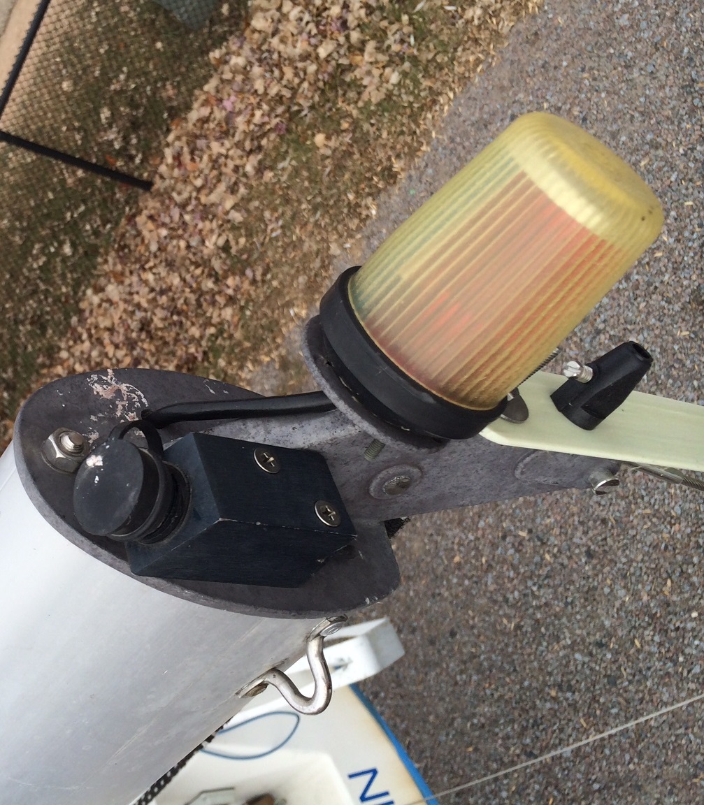

Yellowed masttop light
Nov 8, 2010
11,386
Hey all, my mast-top light lens has yellowed; I suppose to UV, heat, and age. I'm replacing the bulb for a new Marinebeam LED and also have a new fixture, but this one is fine save for the dis-coloring. I have heard that the yellowing is on the surface and can be removed with either Meguiars polish or a science experiment involving hydrogen peroxide and oxi-clean. Anyone with real-world experience?

I would try the stuff sold for yellow/scratched headlights. The vertical ridges my make mechanical polish harder

Tooth paste. Or was told peanut butter. But I know tooth paste works good. Led should give a more white look to lenze

The fluteing is on the inside. The exterior surface is smooth.

My big question is if ANYTHING actually works. If it does I'll make an extra trip to the boat to get the lens so I can have it done when we launch!

I have tried all of the above except peanut butter (read it is only good for a week on a bumper cover when selling a car) with poor results. It looks good for a short while then gets cloudy again quite quickly. For the hassle chuck it.

I polished the yellow off of "Truk", my old Chevy Pickup headlights last winter. Had some free time, a few cold ones so I got out my Makita variable speed buffer and a bottle of Presta Gel Coat Compound, worked it down with Presta Ultra Polish. Looked good and did take the yellow off. I wouldn't want to do it by hand, too much work.

Once it starts it will return. I just replaced mine for the same reason. And my mast is down.

A spindle-mounted polishing wheel would make short work of it.

I've used Meguiars Ultimate Compound on car headlights with astonishing results. I wouldn't have believed it if a friend hadn't demonstrated it to me. I've used headlight polishing kits before, but the Meguiars stuff works just as well without nearly as much work. A bottle is around $8 at discount stores. Never tried it on a mast light, though.
