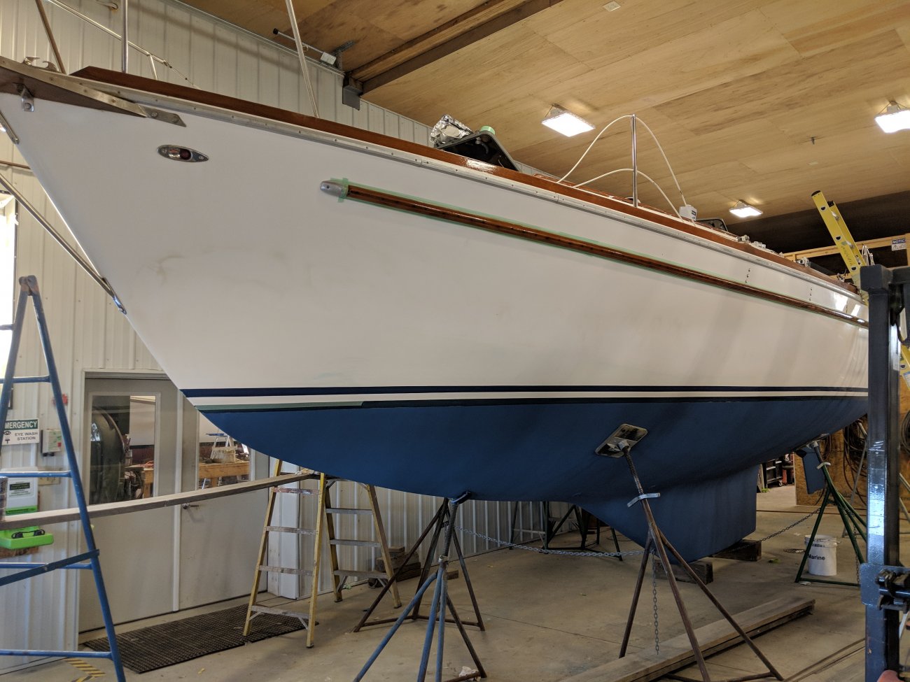

Like David Sailor26 says, it depends on what kind of bottom paint you use. My boat is kept in the water year round. I always use a hard paint, Pettit Trinidad SR, and usually get three years between haul outs. I Hauled my boat last October, 2018, as I am retiring in two weeks and wanted to get all those expensive things done while I still had a nice paycheck. I did not need to haul the boat to paint it as the bottom paint over all was still anti-fouling. No barnacles except on the running gear. The interesting thing is, it was on the 5th year of the bottom paint and it was still going strong and didn't need to be painted. Now I scuba dive so do the bottom about once every month and a half in the warm months or right before one of the three races I enter every year. I keep my boat in Norfolk, Virginia. I use two coats when I paint the bottom. I did put two coats on as well as replaced all my through hulls, added a KIWI- Three blade feathering propeller and line cutter, polished the hull, etc. I hope I am good for another five years before a haul out.
