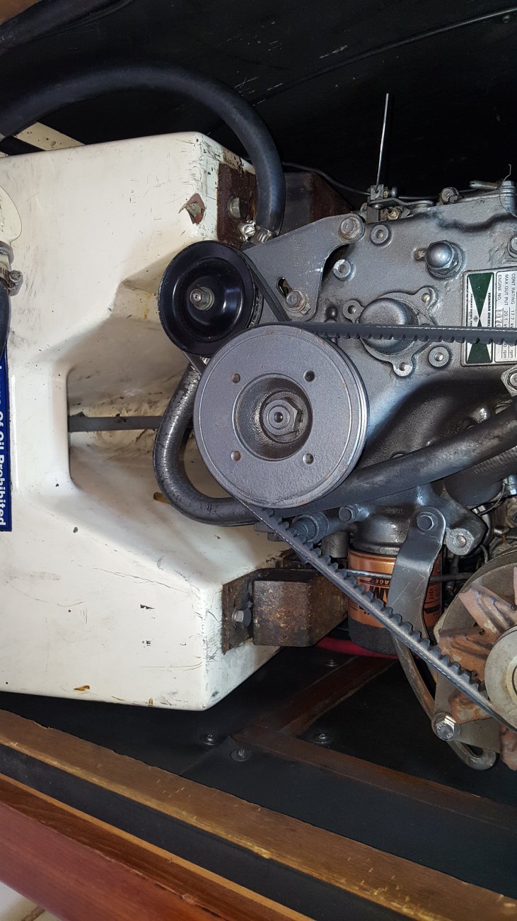

I’ve a Yamaha 33’, and was curious about the difficulty of replacing the stock 2GM with a 3GMD. Can the engine bay incorporate the larger engine?

Yes. Except the motor mounts will not match up because the motor is longer/wider. That means shorter shaft or longer stringers and that means you might need additional clearance on the forward/back end maybe both. Do you have the space? Perhaps the width is different so the stringers will be too narrow. Also likely the height will not match either. These all need to match up otherwise one cannot align the shaft to the motor to say nothing of a solid motor mounting structure. Remember the shaft pushes on the motor, thence on the motor mounts, which pushes or pulls the boat so these things need to be paid attention to.
Just a preview. There are other gremlins in every re-power. They are usually not the nice kind.

Thanks, Charles. Excellent points. I’m okay on width and height, as the only change is the additional length of a cylinder going from the 2GM to 3GM. The engine bay is relatively roomy with the 2GM, so this might work with a bit of fiddling here and there, and certainly a smoother more reliable ride on three cylinders.

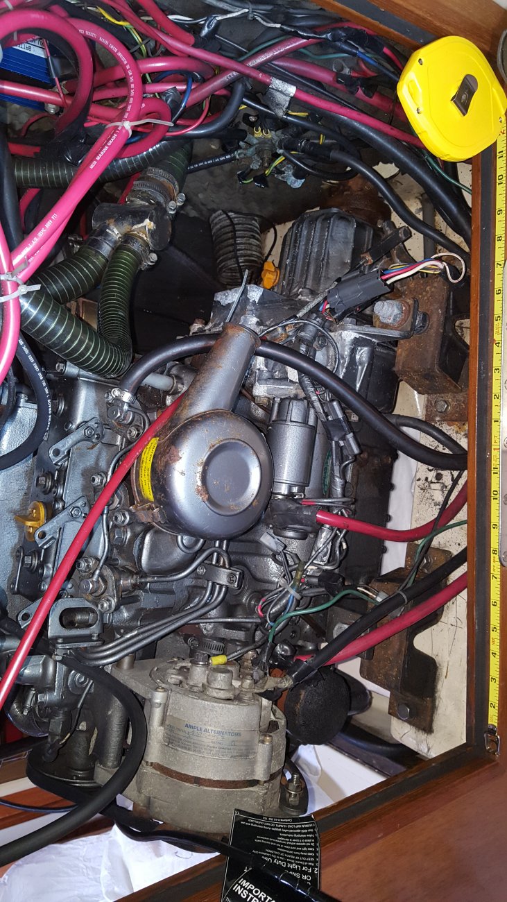

It looks like that 3GM kicked up a bit of a fuss getting in there, but it slotted in perfectly in the end. The adaptation seems quite simple, as it only involves a linear translation. Quite doable, I can see. Thanks, Mike!
