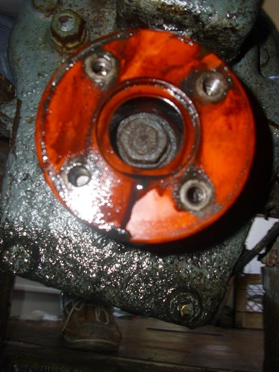

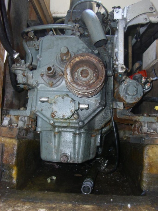

Okay, I got my engine out today, and unfortunately it looks like the leak is not something simple like an oil pan gasket. I suspect it's the rear main.
Considering this is a 35 year old motor, what are the odds of an reasonably inexpensive repair?

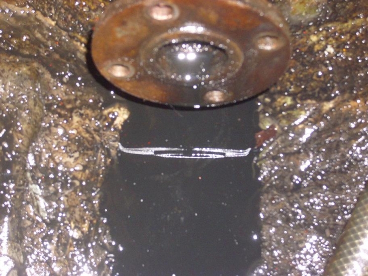

Can't tell what is leaking
I can see that the crank to prop shaft connector is covered with oil but can't see where the shaft enters the engine. The connector is not where the leak is coming from BTW it just has a lot of oil in/on it.

For the sake of compleatness:
If the rear main is leaking it can be two different modes, shaft to seal and seal to pan/block. The shaft to seal requries a seal replacement, the seal to pan just need a coating of gasket sealer. You have the engine out so determining exactly which mode is impossable unless you can run the engine somehow at the angle it is in the boat.
It could be that the engine oil level was maintained too high or the angle that the engine was installed in was too steep. No amount of seal replacement will fix either of those issues BTW

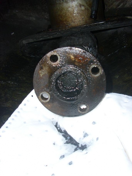

Unfortunately the mechanics discovered the crankshaft is corroded badly and have had no luck finding a replacement. Now I am going over options, a new inboard is out of the question (7K +) and I only paid 7K for the entire boat.
I will have to find a used motor or for now hang an outboard on a sliding mount.

Once upon a time, construction yards used to metal spray cranks and re-grind them. Don't know if they do that anymore. but it may be worth a check to see if they do and if it's an option. Good luck & happy new year!
10,229
I agree with Rick, if the problem really is a corroded crank under the seal area, it can be "plasma sprayed" and reground to std. size. Another option might be a "speedi sleeve" .. a thin metal sleeve that slips over the corroded area so that the seal lip runs on the little stainless sleeve.
http://www.vsm.skf.com/en-US/HeavyDuty/KitsAndTools/SpeediSleeve.aspx. a much cheaper solution, but both probably require that the crank be removed from the block, although there may be a way to fit a sleeve without removing the crank. A GOOD machine shop will be conversant in both these techniques.. Best of luck to ya..

I'm not sure where you are located, but I can certianly direct you to shops in CT that do the process. We use it quite a bit in our work. I have a 1975 H27 with a SB8, it is not all that rusty. From the pictures you provided it appears that the your motor has been wet.... alot. Is there another underlying issue? Stuffing box? Just a thought!
