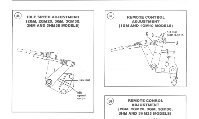

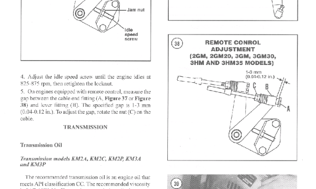

Cables can stretch over time. I've found the simplest solution is to adjust the fuel stop adjustment. If the cable stretches too much when even that won't work, you need a new cable.

weinie, I answered "conceptually" not engine specific. I forget what engine you have. The Universals have the governors inside the starboard forward section of the engine with two 90 degree opposed screws on top of the housing. I would never mess with the governor, but those screws are easy to deal with. The M25 TRACTOR model manual discusses and shows the governor pretty well, page 23 here: http://www.c34.org/manuals/ServiceManual.pdf Remember, these are the guts and for information only! I wouldn't mess with them. The screws on the top are the ones I mean. I've poked around through various manuals and can't specifically find it, sorry.

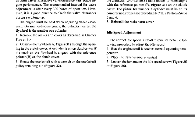

On the Yanmar 2GM20F engine, I think that the idle speed should be about 900 RPM - at least 700 RPM. Check the RPM when you throttle down and see what it is. If it's lower that that, then check manual for setting it higher. I have a owners manual and a service manual, but they are both domn on the boat.
