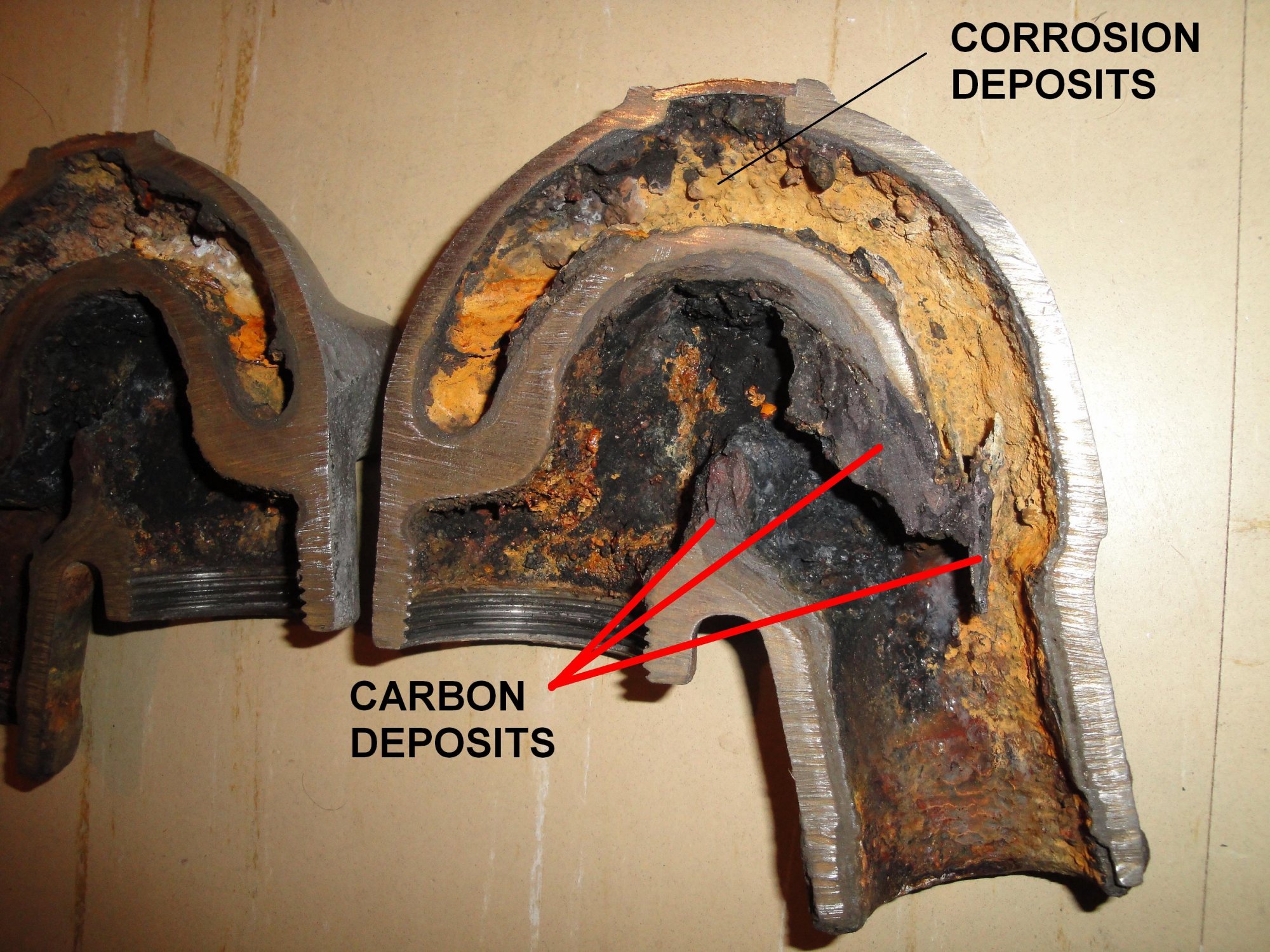

How long since you inspected your mixing elbow ..................... 13 years ? ? ? ?
This could be you :yikes: !
