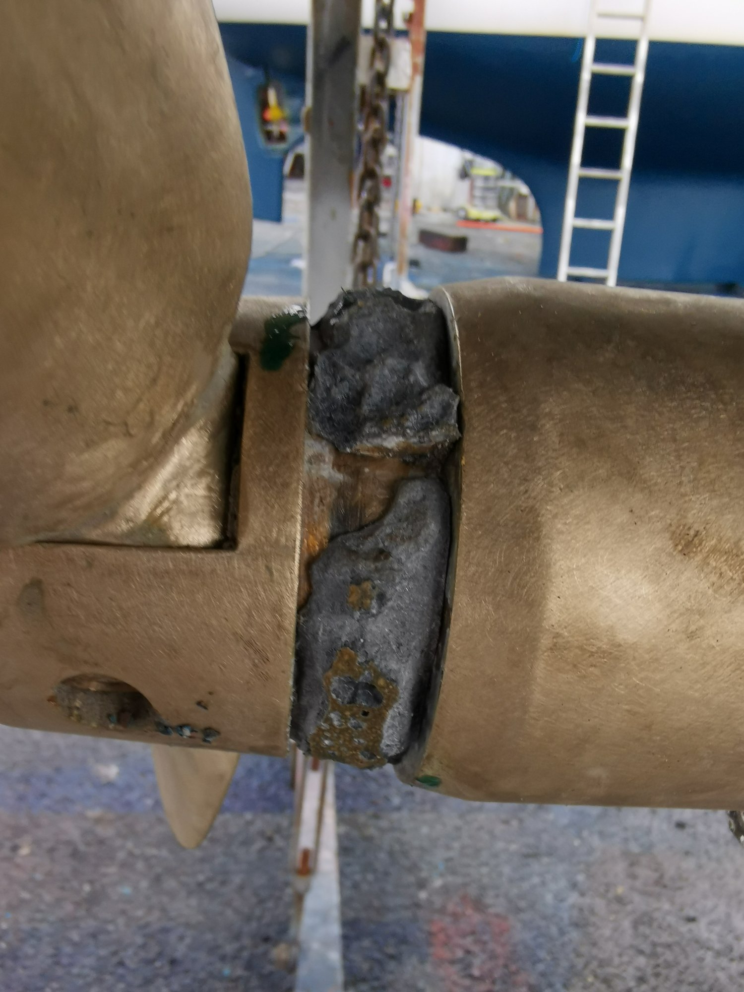

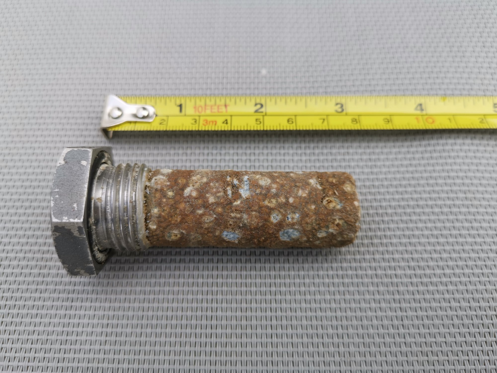

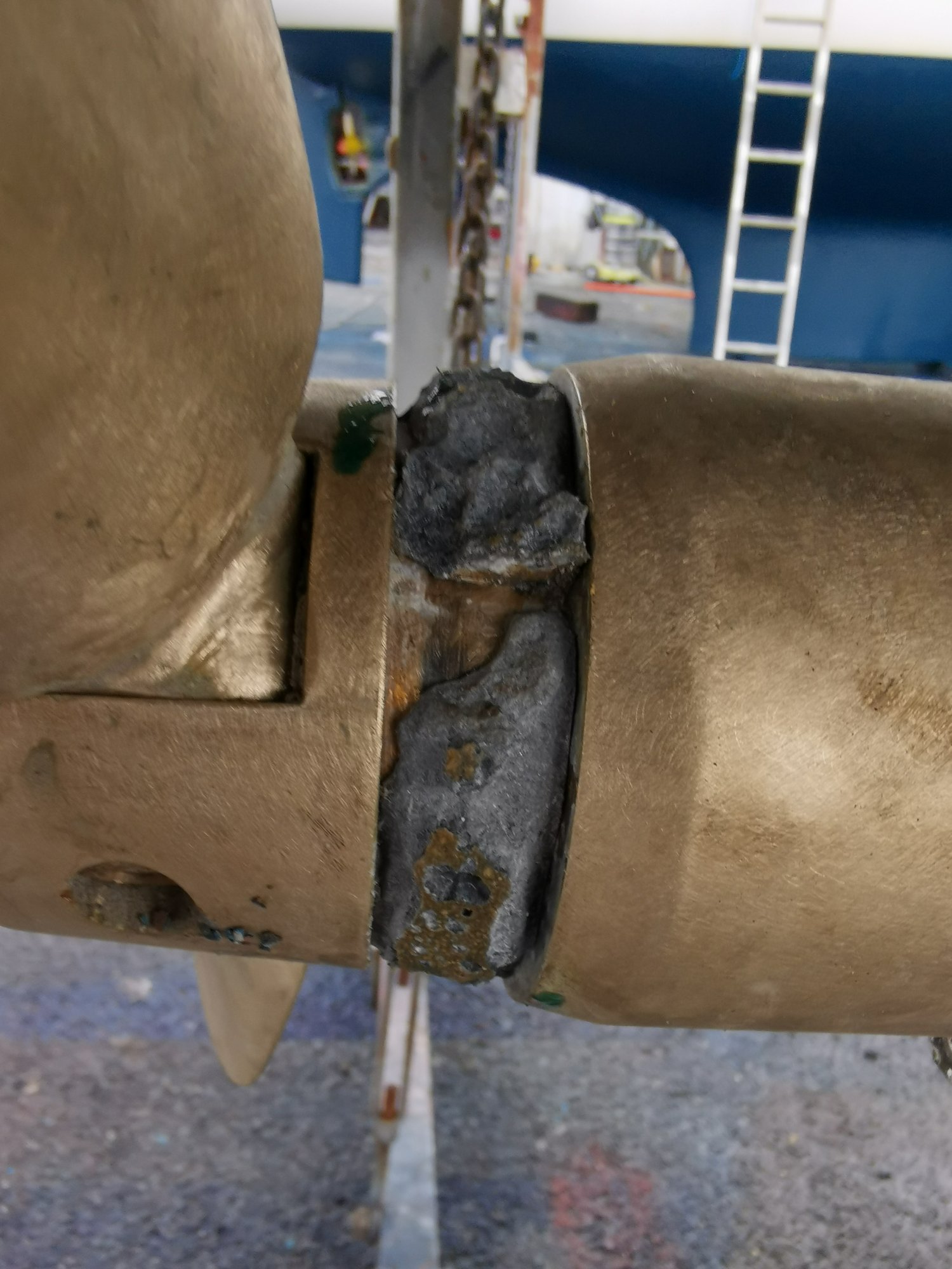

Our boat is 5 years old (I've owned it for 4 months), the engine has done 220 hours and I have no idea of the state of the upper gear case anode. The manual says it should be replaced every 100 hours, but the boat must be out of the water to remove it. The haul-out facility at our marina is closed for 6 months (at least), so my only option is to sail 65NM up the coast to have it done there. Is it worth it, or should I risk waiting another 6 months? I know there is no definitive answer to this, but opinions are welcome.

Can't say if replacement is critical or not. Much depends on how much stray electrical current the previous owner and yourself was/is experiencing. No one has chimed in on replacing theirs accept for me and my experience is not useful because I had a saltwater anode in freshwater, as well as being 200' from shore power. How's the anode by the prop looking? And how many times did the previous owner replace that? If you can get the answers to those two questions, it may help you make your decision.
Whatever you do, take a photo of the old anode and post so we can see what a 5+ year old internal anode looks like.

Thanks for your comments. According to the diver who cleaned the hull a few weeks ago the external anode is fine. I think stray electrical current would not have been an issue with the previous owner as he was on a private mooring. I assume time in water is more important than engine hours, so in that respect I might be getting close as it's never been out of the water for more than a few days.

I had the engine serviced by our local Yanmar dealer and asked him about the internal anode. He said he'd never seen any loss on those anodes and had never had to replace one. He sad as long as the external anode is replaced regularly I need not worry about it. I'll still check it at next haul out and post here.

Your internal had more wear than mine which had the wrong alloy for freshwater. But your external probably could have been replaced sooner. Before you re-use the internal, I'd take a wire brush on a drill and shine it up a bit.

Sadly it's too late to clean it up as we've been back in the water for a week. Maybe next time. I had to put the worn external one back on as it took a week to source a new one. Just had a diver replace it this morning, the old one broke in 2 when he removed it, so good to have that done.
