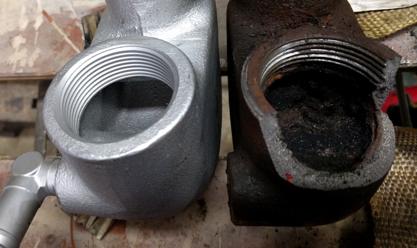

Okay I now have a new exhaust elbow, coupling, and mixing elbow. I ended up spending just a touch under $400 but here is a pic of the mixing elbows. Yes I know I broke the old one. I didn't realize it is a LEFT HAND THREAD.
I fired it up right after changing it but it didn't start easily. We'll see how it works once I go out and play with it.

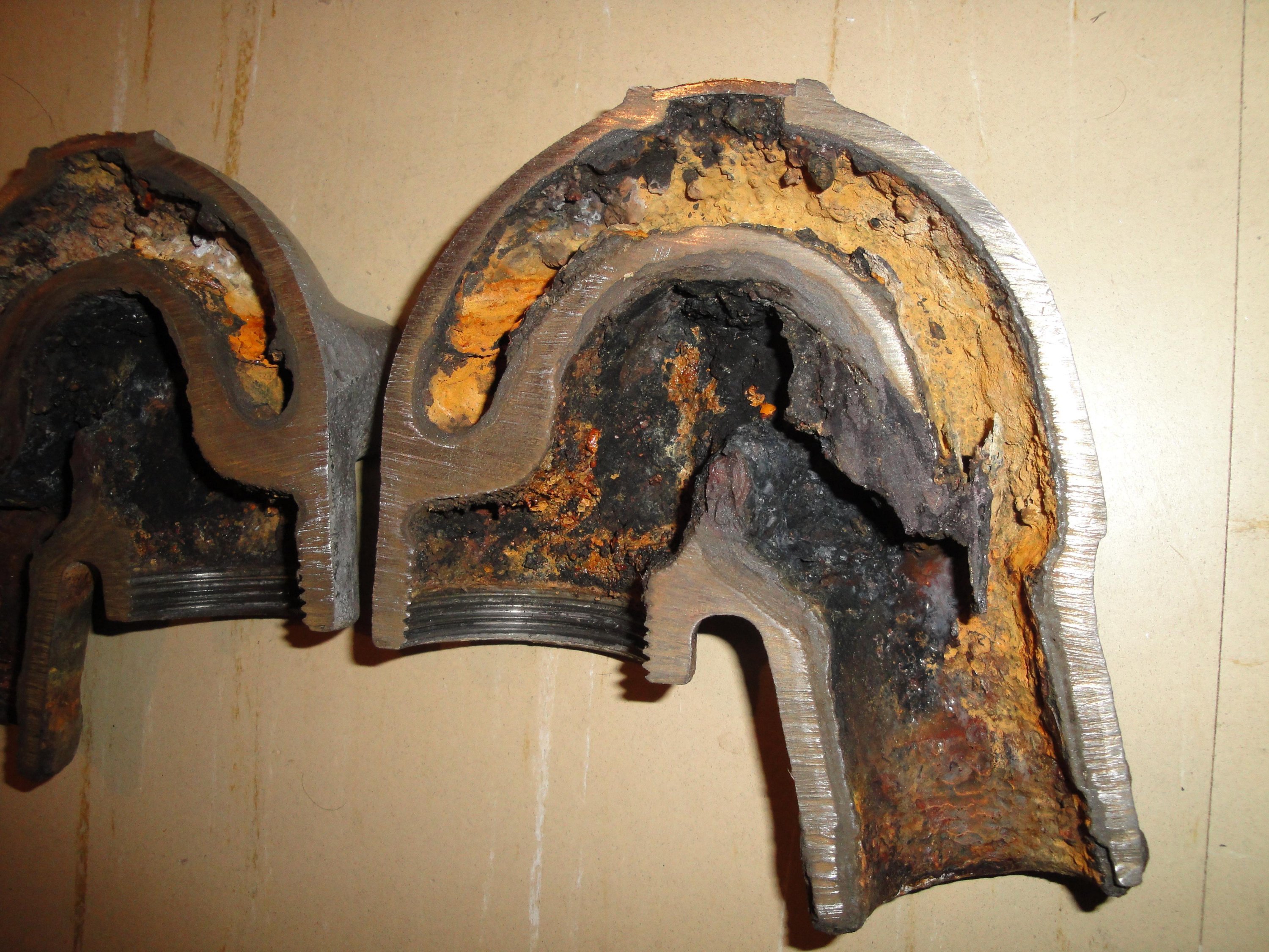

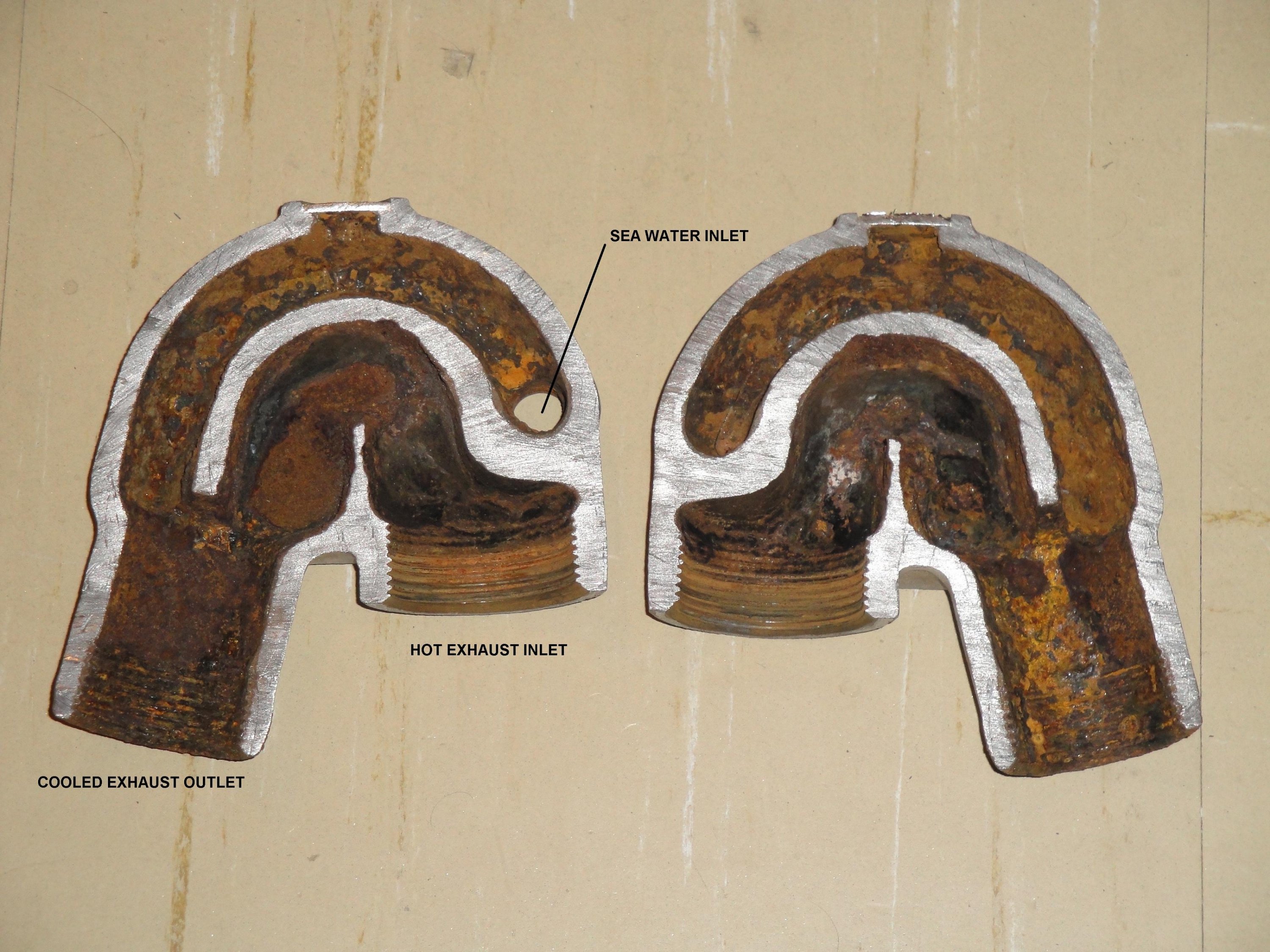

I'm puzzled for just the opposite reason. I don't seem to get more than 400-500 hours before my elbow is coked and choked. It seems to be split both ways on this site ............. some don't see any ill effects while others suffer the same effects which I've experienced. Can't say the water passage is any great shakes either as shown below.
In the battered ruin above, notice the small dam (causes a sharp turn) for the exhaust gasses is almost completely gone as opposed to the picture below of a cleaned out elbow ...............
