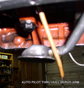

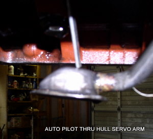

I did exactly that the year I bought my boat. Removed and tapped a 90 degree bronze elbow into the pan facing forward. To that I added a small ball valve from an old Jaguar radiator. For oil changes I slide a one gallon anti freeze jug under the oil pan drain with a hole cut out. I open the ball valve and let gravity do all the work. I usually let it drain overnight and close and fill the next day. The engine only holds 3 qts so the gallon jug is just fine. Never any mess or cussin' and ALL the oil is changed.
