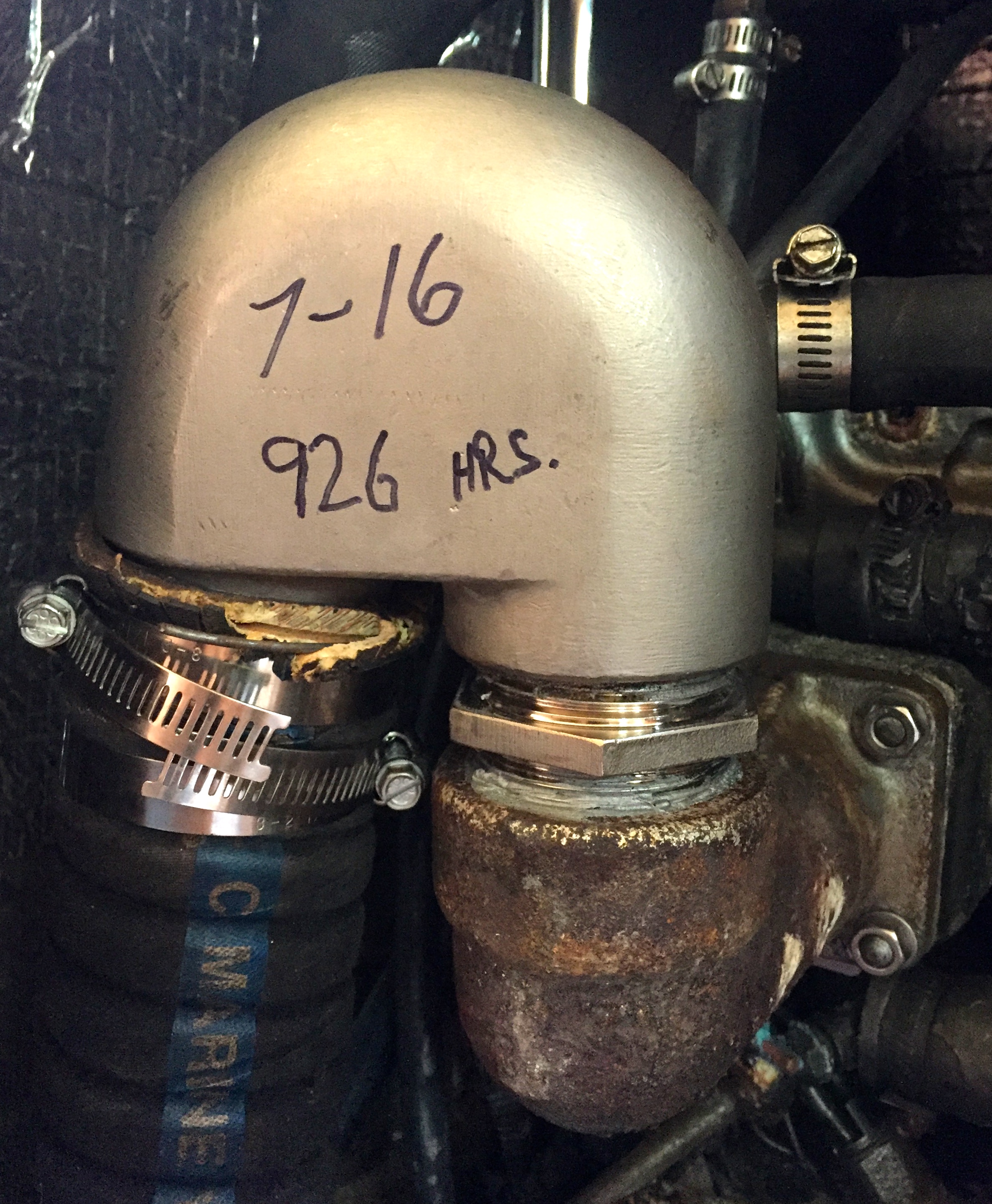

I replaced mine just last month with SS. Got a giant crescent wrench and pipe wrench at Harbor freight. I'll never use these again.
My old elbow had some carbon but no evidence of corrosion. I don't think she has ever seen salt water though.
If anyone wants my old cast iron part, it's yours for the price of shipping.
