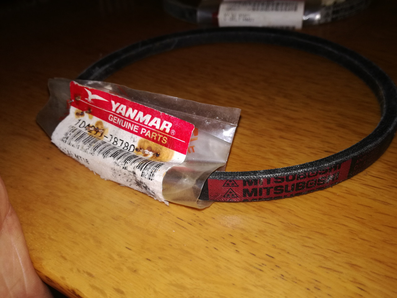

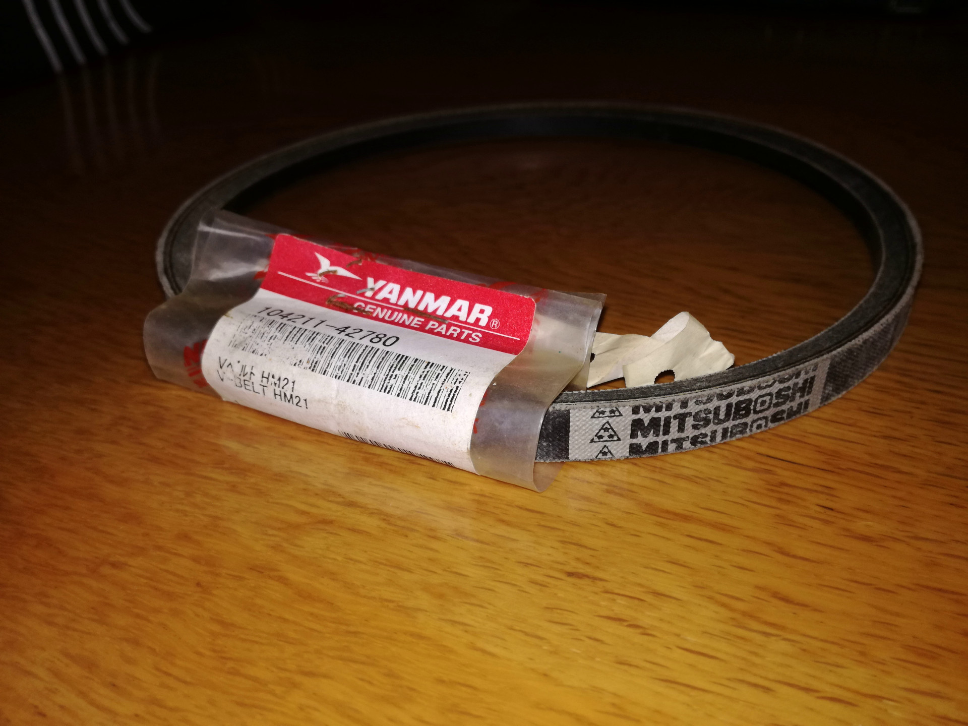

Belts.
Well. luckily the PO had already bought spare genuine Yanmar belts so I didn't have to worry about choosing Yanmar or third party parts.
The only thing that has me confused is the actual brand on the belts.

Yanmar uses other manufacturers to produce some Yanmar parts, belts, hoses, filters and probably more. These are simply rebranded parts. It is a common practice. It appears your Yanmar belts were made by Mitsubishi, as you know a large conglomerate that makes all kinds of things, apparently V-belts are among them.
East Penn Battery produces batteries under its own brand, Deka, as well under the NAPA brand and I think some West Marine batteries. Wix sells fuel and oil filters under its own brand as well as NAPA. There are many others.
