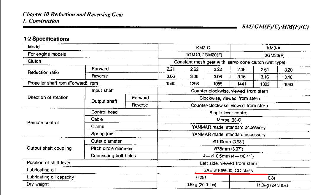

Page 16 of the manual that came with my 2GM20F states that the KM series gearbox (mechanical cone clutch) uses the same oil as the engine. The KBW series gearbox uses ATF-A. There is a note below that that simply says "Do not use ATF-A in KM series..."
To me its pretty clear that the significant difference results from the gearbox type.

10W30 oil entails that when cold the viscosity of the should be 10 and at 100F it should be 30. I doubt the oil in the transmission reaches 100F so the multigrade might a little thin. If the manufacturer calls for 30W oil use a single grade oil. Although we may be splitting hairs here as these transmissions are hardy and have proven to run on all grades of oil.

I think we are going overboard on this. 30W motor oil has been the lubricant of choice for transmissions not requiring ATF for decades with good results. Why try to play Chemists?

+1 to Benny and Ralph. You can't go wrong with the manual UNLESS someone posts - not quotes- a factory bulletin stating otherwise.
