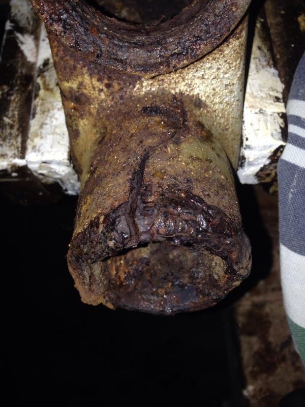

I'm having my two yearly rant about the inadequacy of the design or fit for purpose of the Yanmar Exhaust Mixing Elbow (3YM30 on my 2004 H33)
The one shown below achieved 300 hours. I am trying a new cast aluminium one this time.
10,215
What is wrong with it, Nick? Can't see inside.. if it is plugged, you can carefully chip out the coke/salt deposits .. .. Cast aluminum.. interesting.. where is it available?

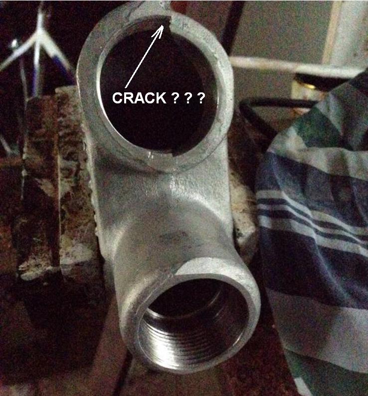

Got to ask ............. in your first photo, is that a crack in the discharge or is it just the picture ?

The old cast iron one didn't look that bad to me. Couple of minutes on a wire wheel and she would be good as new.

I agree that yours looks bad, but 10 years and 300 hrs is not all that bad. I am curious on how you run your engine. Do you run it at low RPM's or are you running at 2500 - 3000 when motoring?

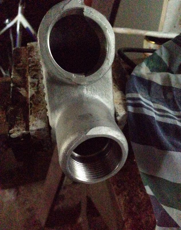

I found it on eBay and the supplier is a company called Marina's Marina Inc in Barnegat NJ. (609) 698 1222. It's a family owned company and they are very knowledgable and friendly. It's made of marine grade Al and they claim it outperforms the Yanmar item. It cost $159 and they delivered it to Australia in fiver days. We will see how it goes!!

No it's not a crack! Just the light on the Al
See my previous reply re origin of the Al elbow

It's. 300 hours in two years. This is my fourth elbow ten years which I don't think is good enough.
