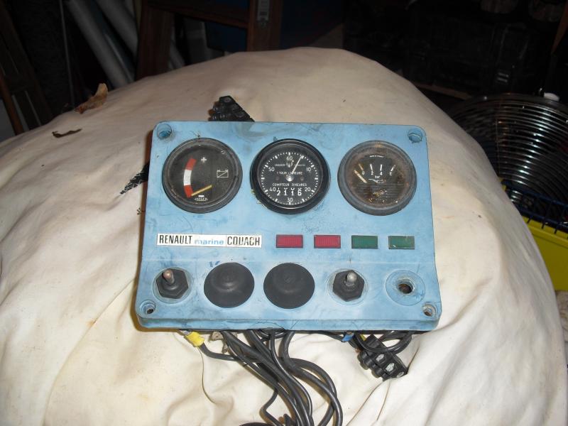

keith, can u post a picture, I have an old panel with a tach, oil and charge guages, if the guages fit u can have it, I see if I can post a pic. Red

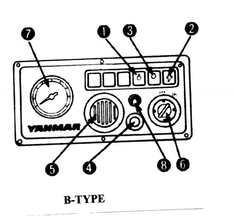

No pictures I have it put away for the winter but here is a drawing form the manual. Please take a look and let me know if it looks like the one. PM me for address and payment
Thanks
Keith

I have the type b panel - do you have descriptions of the numbers.
Are the other indicators blank or do they have a purpose. We just acquired a 1984 31H and don't have much documentation.

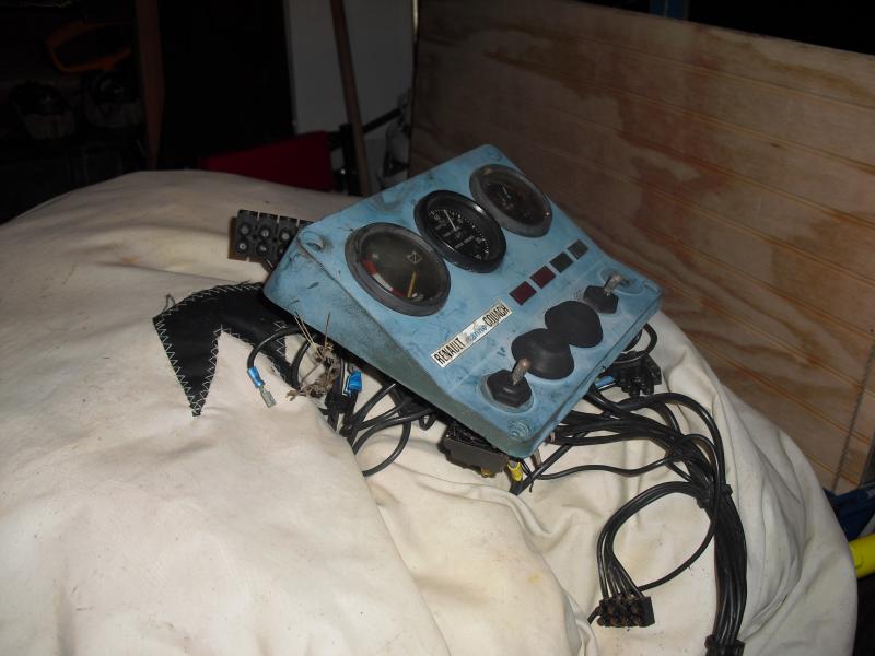

guage panel
keith, here are pics of my old guage panel from a Jeanneau, if the base will work u can have it...I don't remember if the guages work. Red
Feb 22, 2004
222
Hunter H340 Michigan City
Thanks, but it looks like it will not fit in the space I have for it. Mine is not as tall, I appreciate it very much though.

Mark, what do you mean a descriptions of the numbers? Do you mean the call outs on the diagram?
