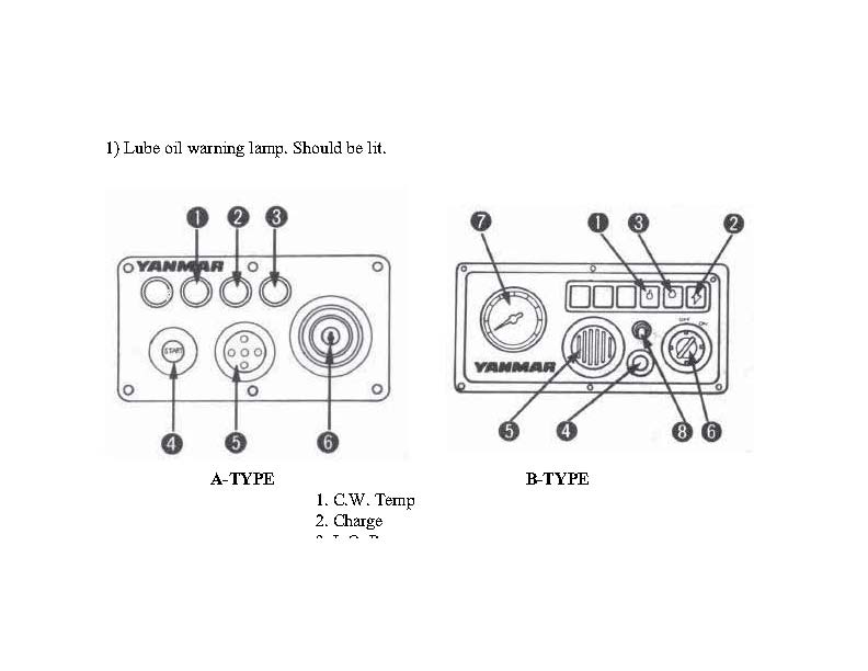

I recently purchased a 1985 303 with the 2GM Yanmar engine. I am having some difficulty getting the engine to start. It does start, but only after several attempts. I've read the manual and see where with the 1GM you are suppose to pre-warm up the engine first, but I can find no instructions on pre-warming this model and my throttle does not have the warm-up knob. I have the "B_Type" control panel. The manual does not identify what the toggle switch labeled # 8 is for, and I am wondering if this has to do with the pre-warming. Any thoughts would be appreciated.

The switch you are referring to should be the "lamp test" switch. It should be a momentary style that will illuminate your warning lights to make sure the bulbs are working. The factory Yanmar manual is less than helpful for a lot of things. Seloc makes a pretty nice Yanmar manual, and I'm sure there are others out there.

The toggle is a light switch. Check for fuel leaks. Any fuel leak could cause air to enter the system. The engine should be nice and dry. I do have a manual and am trying to trouble shoot the problem.
