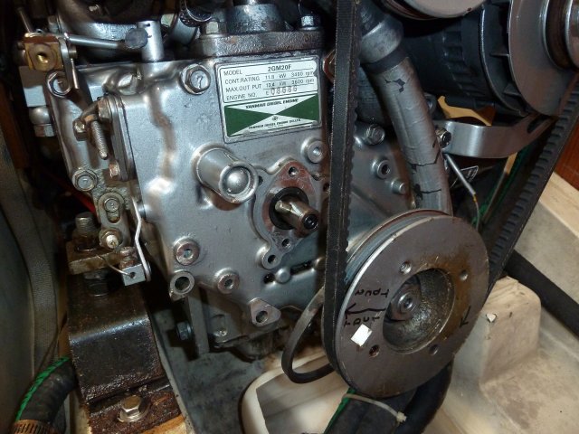

Yanmar 2GF 18 horse 1993 (2000 hours on it).
Noticed two places on the absorbant where some oil has dripped, under the front face (seemingly from a small round faceplate behind the belt about the center of the engine above and to the right of the water-pump ... what is that faceplate?) and also under the rear of the engine and I can't see a source.
Is it likely the oil could come down the front and find it's way to the rear before falling on the absorbant or do I have two leaks? There is a few tablespoons on oil on the absorbant in total.

eliem, the oil leak at front of engine sounds like coming from the starting shaft (hand crank) you probably haven't fitted this option so it's just a shaft with a cover on it. The oil seal in mine was leaking oil. It's a quick and easy fix (if that's source of your problem). Get a small screw driver, pry out the oil seal, bring it to a car parts shop as sample to get a new one, clean hole where the seal sits in and pop the new seal in that's all. If that's not your problem, then good luck with troubleshooting. Cheers.

Yes it is ... so it is a hand crank window? OK, one oil seal coming up.
