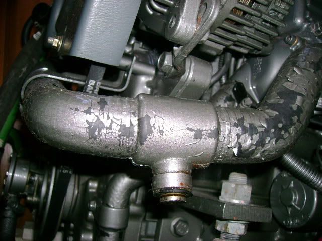

Yanmar coolant drain
I've tried this a couple of times, this drain plug has been leaking. Does anyone know how it actually works??
