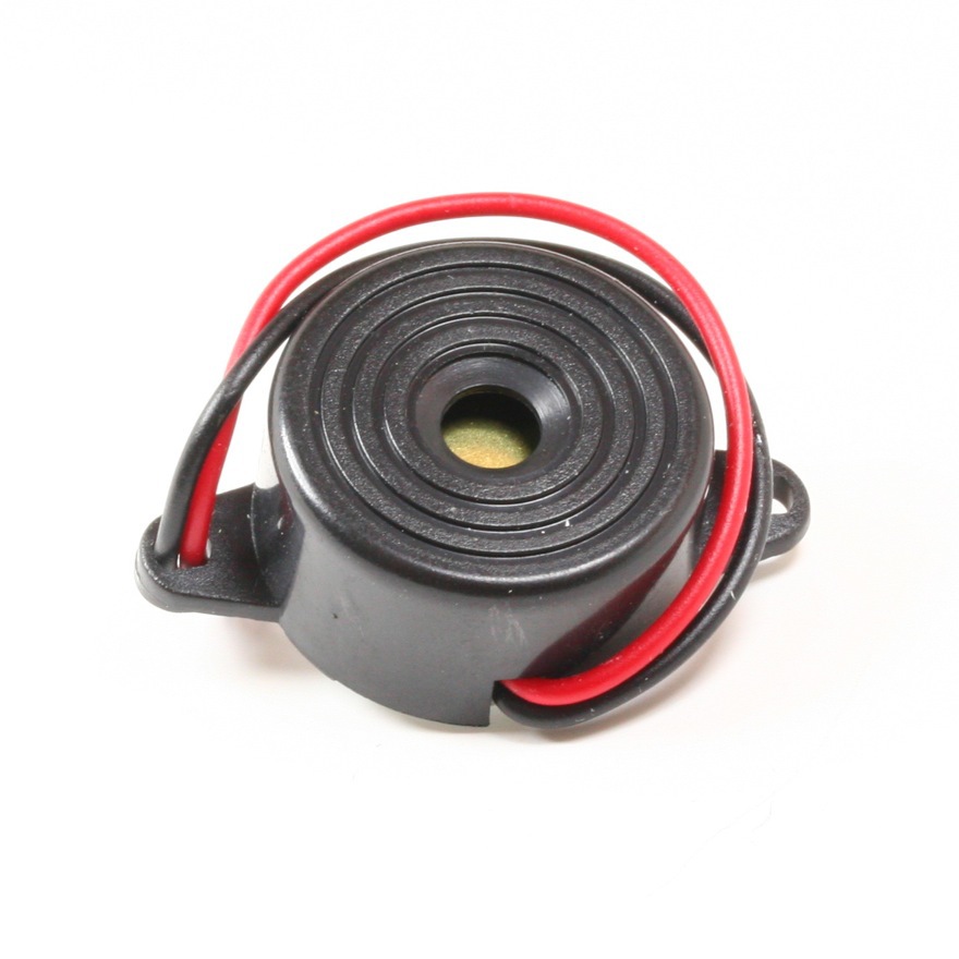

Like Ken indicates the toggle switch only tests the "temperature" sensor circuit but not the "charging" circuit nor the "oil pressure circuit". The fact that you hear the alarm when you activate the toggle switch is a good sign as it means that the "buzzer" which services all three circuits is operational. That buzzer is rather expensive at close to $200 if it ever needs replacing. Check all the electrical connections (clean and tight) at the back of the panel and at the engine end. If everything looks well but no power to the sensors I would conduct a visual inspection of the wire harness from engine to panel. This means crawling under the cockpit sole. Look specially around bends for chaffed harness insulation; as the hull flexes over many years it can cut through the harness at sharp fiberglass edges. Get a digital multi meter and check for continuity and voltage in the circuits.

In the event that you just can't stomach the high cost of a new buzzer, it can be replaced with an electronic alert (like a Sonalert) some diodes and one dropping resistor.
It just depends on how much engineering you want to do.
