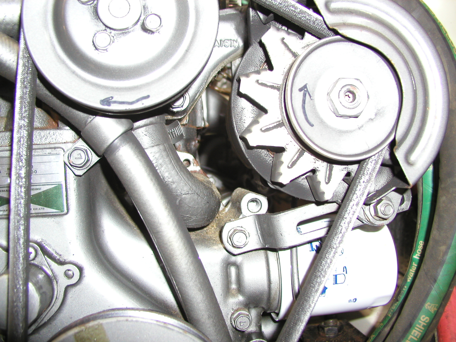

9,226
From my engine.. No problem with it loosening.. plenty adjustment left to take up slack.
