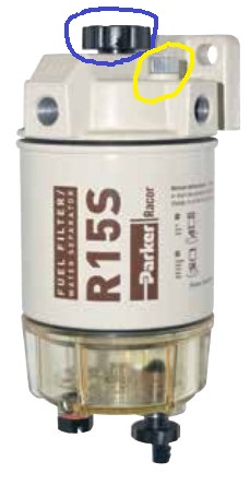

I got around to changing the primary and secondary fuel filters on the Yanmar 4JH4E on our Hunter 41DS. I've owned diesel trucks for years and successfully changed fuel filters with no problem. But on this, the first filter change since we got the boat, I'm not having any luck getting the engine to start. It fires right away and then quits.
I've attached photos of the primary and secondary filters. The primary is a Racor 230R2 with a R20T filter. The image is actually an R215R2 but it's the best image that I could find online that is similar to the 230R2 that I have. On the Racor filter image I've circled the priming pump knob in blue and the bleed screw in yellow. After installing both new filters, I opened the fuel tank petcock and backed out the bleed screw on the Racor and pumped away on the primer plunger until I was getting bubble-free diesel coming out of the bleed screw and then tightened both the primer plunger and the bleed screw.
Then, I moved on to the secondary filter, a photo of which is attached. The screw that is circled in yellow was loosened and I pumped fuel using the manual lever of the lift pump until I got bubble-free diesel coming out.
With the raw water intake closed, I attempted to start the engine. Although the engine did fire right away it died in a few seconds and it would do this on every start attempt. I went back and bled the secondary filter some more and got some bubbles but they cleared quickly. Attempting to start the engine produced the same response.
I would like some feedback on whether or not what I did was correct and, if not, what I should have done. Secondly, I'd like some advice on what to try next. Perhaps the injector lines need to be bled, too?
