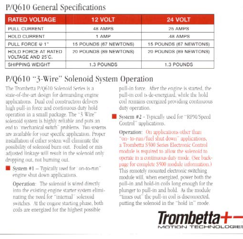

Two years ago I was going to install a Trombetta P/Q610 Series solenoid but decided it wasn't worth the cost for just an extra toy. If all engine shut down solenoids work the same, the solenoid requires a large pull in current of 48A and then immediately goes to a holding current of 1A as shown in the manual :
The solenoid requires power to allow the fuel rack to open.
If the stop solenoid was continually powered, the boat would have burned up awhile ago.
If the solenoid had stayed in the "pull current" position they would have burned out but they always require power for the engine to run. When you punch the STOP button, power is disconnected from the solenoid and the fuel rack returns to the no fuel position. Engine stops.
This can happen (but very infrequently) in 2 ways.
a corroroded push button that stays stuck when you pus it
In this case, the engine would never start. This is starting to lean towards the OP's problem but his engine does eventually start after a long cranking session and then goes at any and all speeds. I don't think this applies to the OP's question.
Not all diesels operate that way. The generators that I work on do require power to the fuel "run" solenoid to operate. My Yanmar 3YM20 requires power to the "stop" solenoid to stop the engine.
