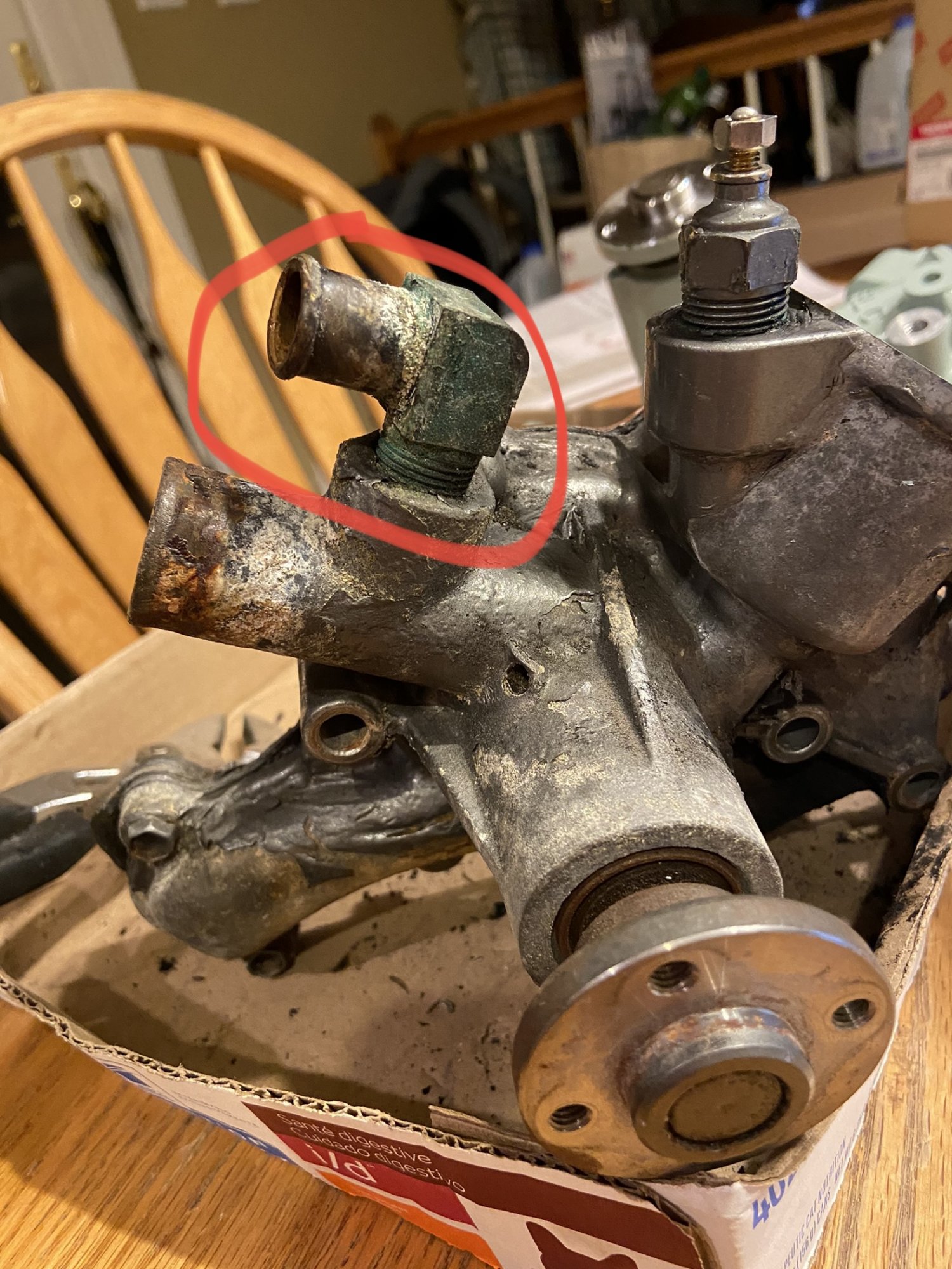

Yanmar 4jh2-te connector type to feed hot water from water pump

That is a good recommendation. I was looking to see if it really is plumbing fitting I can buy at HomeDepit or someplace similar
Hi Keith, HD might have a fitting like that, but a plumbing supply house could do a better job of matching one for you. Did your original pump fail and what were the symptoms; leaking bearing, over heating?
Jan 4, 2006
7,441

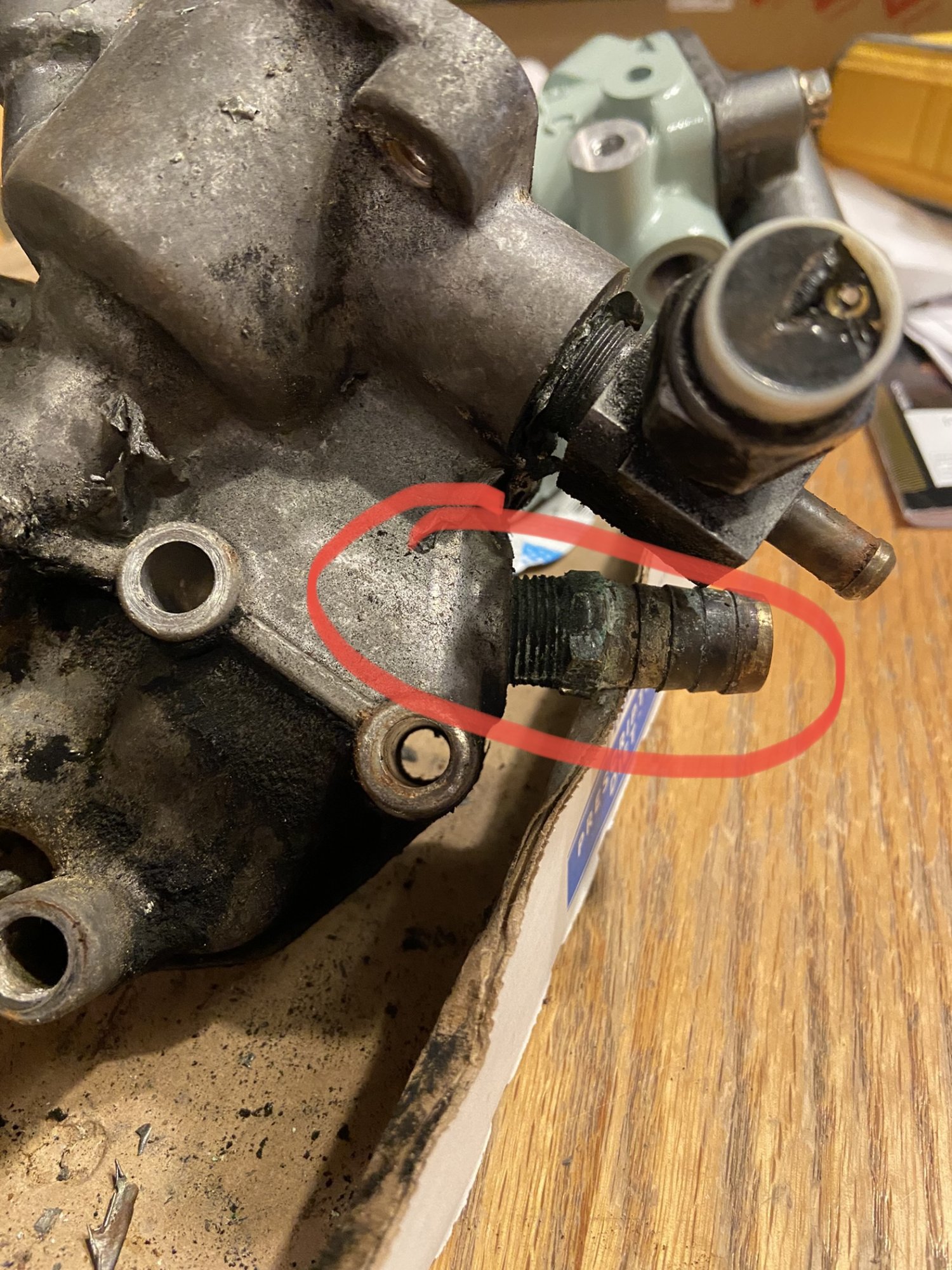

If you've got a Home Depot near you, I will guarantee they've got a 90 deg. barbed adapter which you show. If you should experience a failed guarantee (on my part), head for the nearest marine supplier as they're as common as barnacles on your prop. No need to worry about whether it's brass, bronze, or mystery metal as it's going into your glycol system which protects everything. You'll find their adapters will have a barb rather than the single ring fitting you have shown. These are even a better design although you don't require anything special.
Best to take the original with you, but from way up here, it looks like a 1/2" MPT fitting with the hose size yet unknown. Clean the female fitting a bit, a dab of thread sealant or piece of teflon tape, and you're now a plumber, butt crack and all.
Overheating above 1800 rpm. Have not found any clogs in the sea water system or the freshwater system. So decided to replace the pump while I have it all apart.
