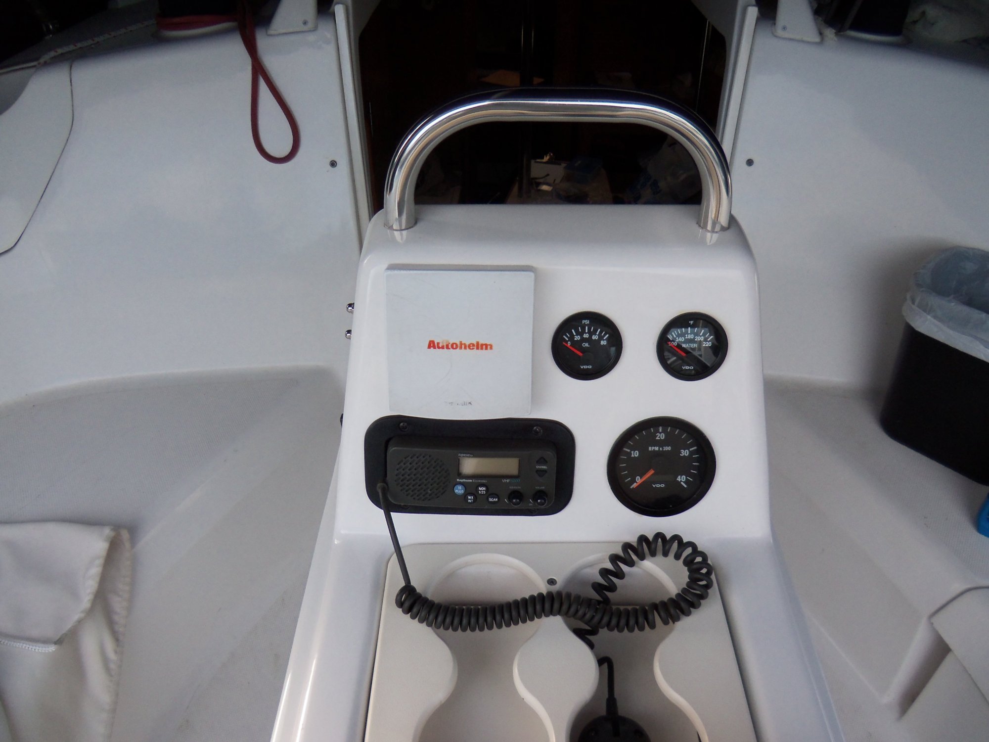

I replaced the original tack (no name brand or at least none recognizable) with a VDO 333-163 because it had the same hole size and matched the appearance of the rest of the gauges. Used the flywheel pickup for the RPM sensing and an optical tack for the final calibration. Could have done the final calibration by calculation but had the optical tack around. Has behaved perfectly for the last ten years.
