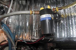

This statement is true if you attempt to vacuum out the oil through the dipstick port. The dipstick port is usually located in the center of the engine to provide a correct oil level reading despite the fact that the engine is pitched down in the rear. When you vacuum through the dipstick port you will not reach any of the oil that remains in the lower rear portion of the sump. You can do a pretty effective oil change this way if you do this twice while running the engine between the two changes. Or, you may be able to insert your vacuum hose into the very rear of the oil sump by wiggling it down through the oil fill port and into the valve pushrod space in the engine block. I do this on my Yanmar 2QM15 every year and completely drain the sump in one pass. It takes a little patience to get the hose down there past various obstructions (cam shaft) but, at least, in my case, can be done in less than a minute. See photo.
