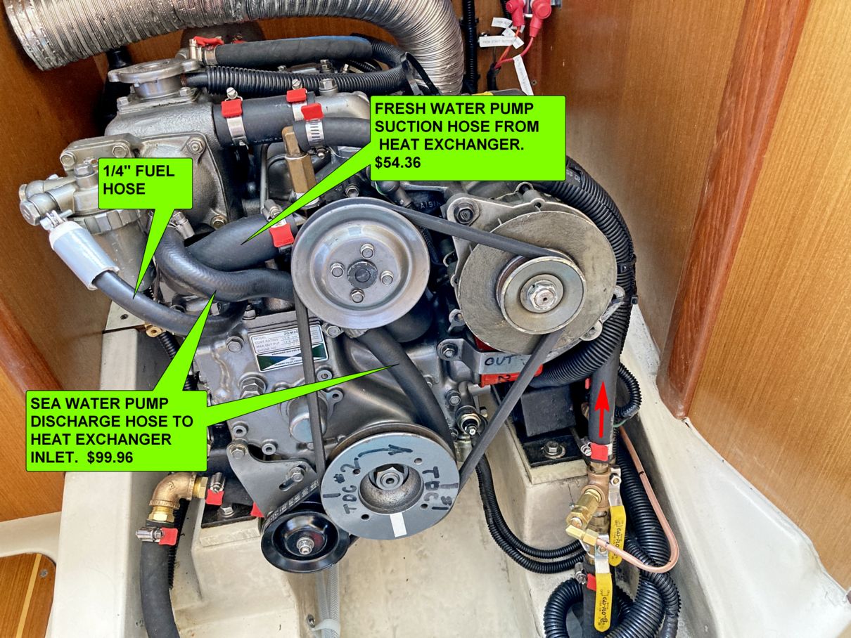

As I slowly replace parts on our Hunter 386 sailboat, I was thinking of tackling the water/coolant lines on our Yanmar engine. Is it worth purchasing off the shelf hose ( if so where) and trying to bend it or should I replace with original Yanmar hose? Thanks in advance,
14,055
Depends which lines. The long hoses from the engine to the HW tank, it is not necessary to buy the Yanmar hoses, same with intake hoses from the sea strainer to pump. The other short formed hoses, buy the Yanmar hoses. And if you replace the fuel return hoses, buy the Yanmar hoses, standard ¼" fuel hoses don't quit fit and will leak.
I buy my Yanmar parts from Niemiec Marine, good prices and good service.
Jan 4, 2006
7,681
Ensure hoses which are subject to suction are wire wound so they stay round. Ensure hoses to and from the HW tank are wire wound to allow them to go around tight corners without collapsing. Ensure there is a defibrillator nearby when you see the price of this stuff :yikes: .
Most hoses that fit up against the body of the engine are preformed and hence purchased from Yanmar. Ensure you have two defibrillators nearby when you see the price of these little buggers :
Long hoses to and from other equipment are not Yanmar parts according to the Yanmar parts catalogues. The bulk 1/4" certified marine fuel hoses are a little snug on the existing fittings but can be stretched with a hair dryer. Lubricate all fuel hoses with Superlube to get them on and off in the future. Same applies to other hoses which are a tight fit.

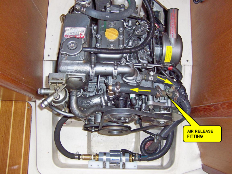

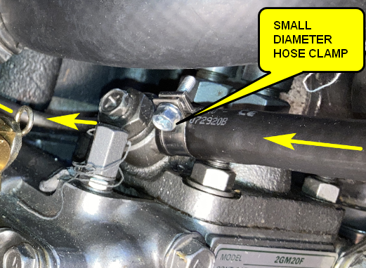

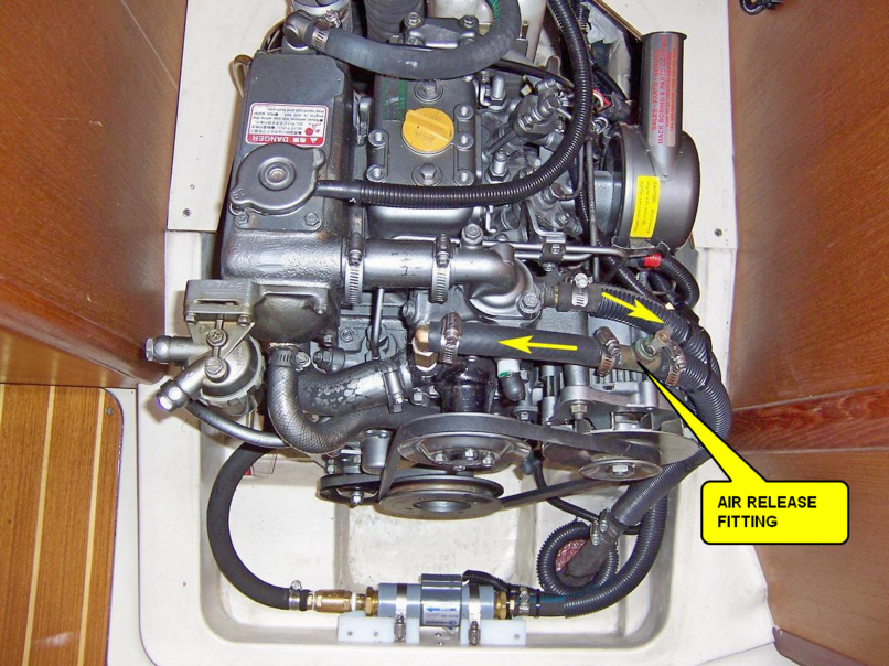

Does your 3JH3E have an air release fitting as does the 2GM20F ?
As I'm adding AF, the vent is open and a continuous hiss of air can be heard as the AF level rises. When liquid escapes the vent, the system is 100% full and no blocking bubbles in the system.

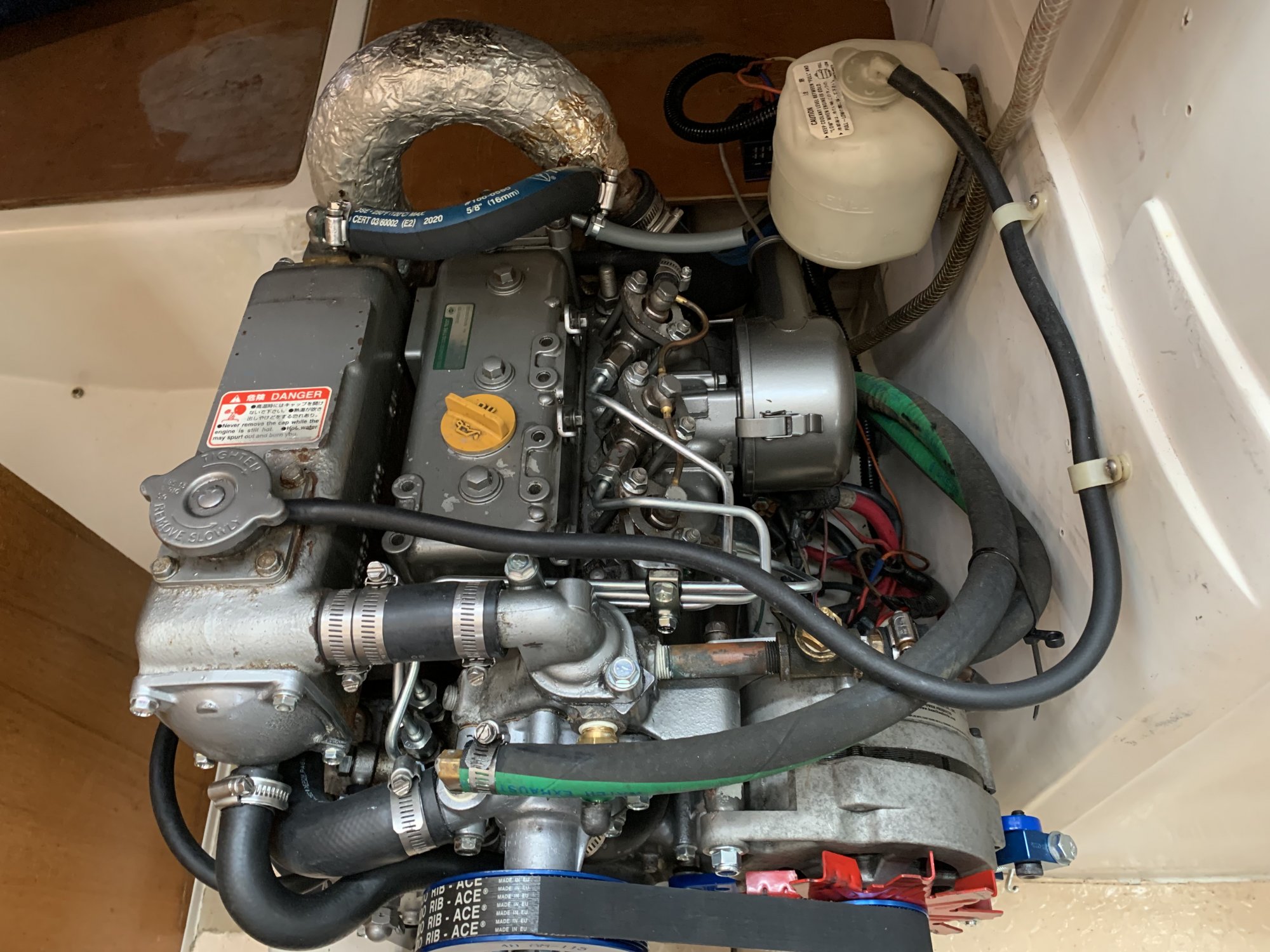

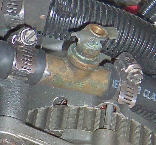

Don't know how your AF refilling goes on your 3GM30F re bubbles in the cooling system, but I see you don't have an air release fitting. My vent was originally (from the factory) installed much lower near the floor and I had a hell of a time with overheating each time I changed the AF. I moved it higher up (see post #8) and have never had an overheating problem since.

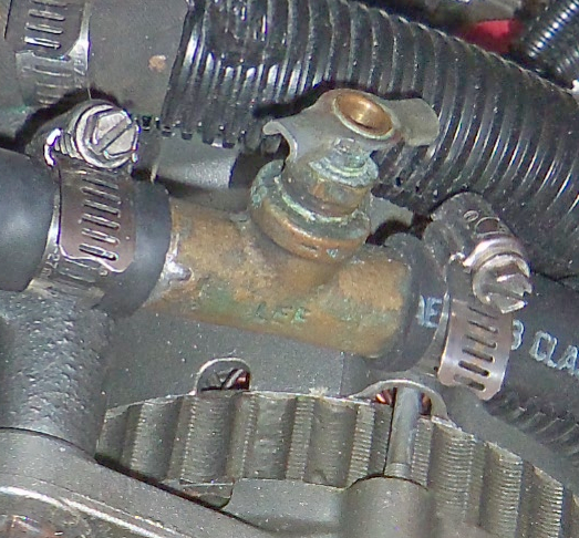

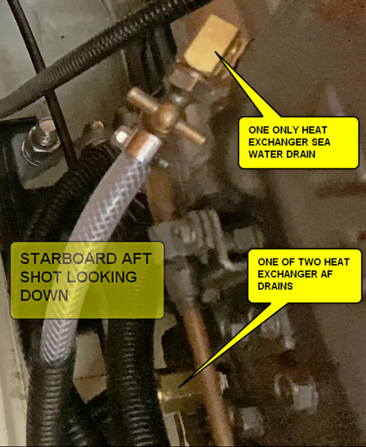

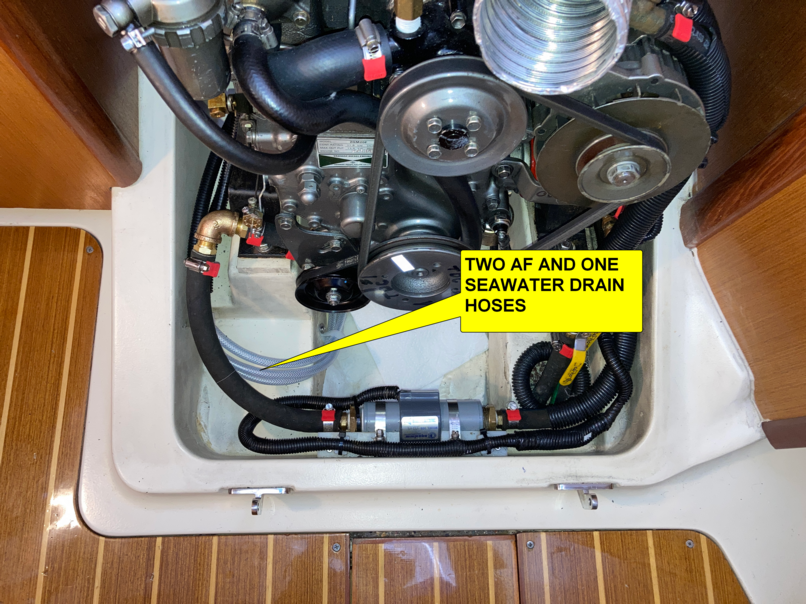

I have 3 bleeder lines to drain the AF. Maybe I'll video this when I do it. Then I don't have to remember next time :)
I like that idea. Not sure if we have one though. I could install.
Sep 11, 2019
173
Hunter 386 Lake St. Clair
Reviewing your attachment, it looks like your bleeder is for the Sea Water hose?
